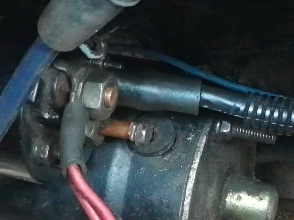

Hello I've got a problem that's got me stumped. My starter will work perfectly normal testing it on a table, but you put it in the truck and even without the signal wire connected, just the main power connected, as soon as you reconnect the ground the motor wants to run. It's not even engaging the flywheel doing this because the solenoid's not energized to throw out the pinion. Anyway I've taken it on and off 1/2 a dozen times without finding the culprit. There's a spring between the plastic cap and the copper disc that pushes it away from the contacts, what am I missing?

Well, I'm not sure. Pictures of the wiring connected on the truck and pictures of it being bench tested could give us clue. My gut instinct is that when you are tightening the positive connection on the start when it's in the truck the connection is swinging around far enough to hit the "signal wire". I've seen that happen before. A starter is a pretty simple circuit, ground, power and signal. The only two possibilities I can think of is a wiring mistake on installation or internal short.

@SirRobyn0 I fixed it actually, you gave me the idea, the power wire wasn't wrapping around to hit the signal wire, it was wrapping around to hit the contact that runs the motor on the bottom.
This was it after I fixed it, I saw that heavy duty insulation and didn't think about it I guess
Anyway thanks
Anyway thanks
Makes perfect sense, glad you got it taken care of!
