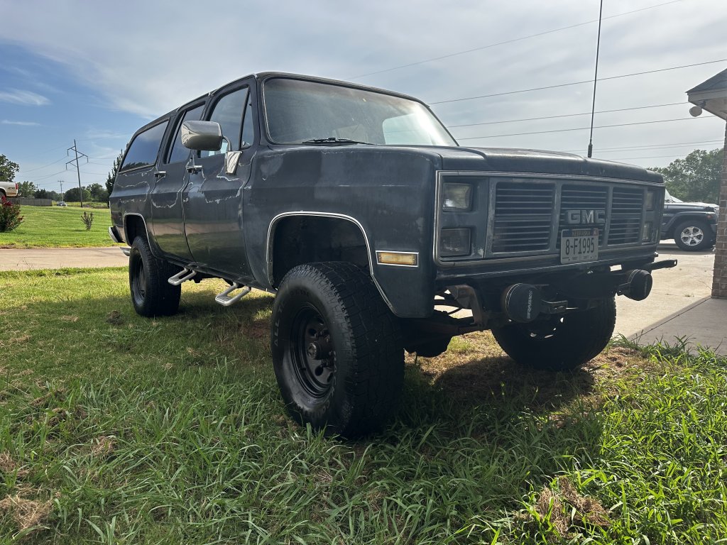

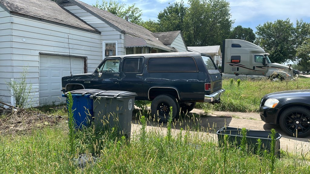

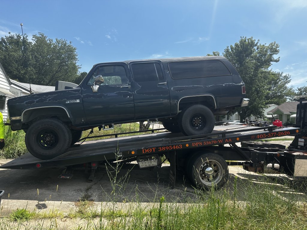

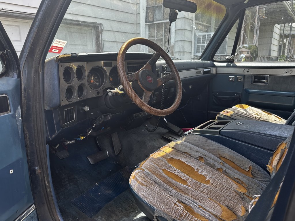

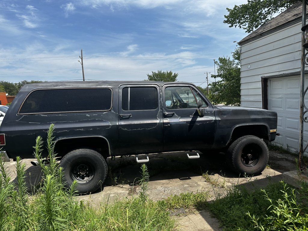

Hey guys I just picked up my 86 burb today! Main thing I need to address is the brakes since I have to stomp on it to get it to stop. Seems to have brake fluid because in moving the cap around some spilled down the side on the master cylinder.
Should I just do brakes all around or do I need to adjust something? I haven’t seen the brakes yet because I don’t have a jack or stands- have to wait to get it in the shop Wednesday but wanted to see if I could do something myself to fix this.
Also it’s been sitting a year but I flushed the fuel line and got it started right up! So far planning a complete fluid flush, brakes and interior then paint later. Let me know if I should address anything else- I’m taking it cross country next week!
