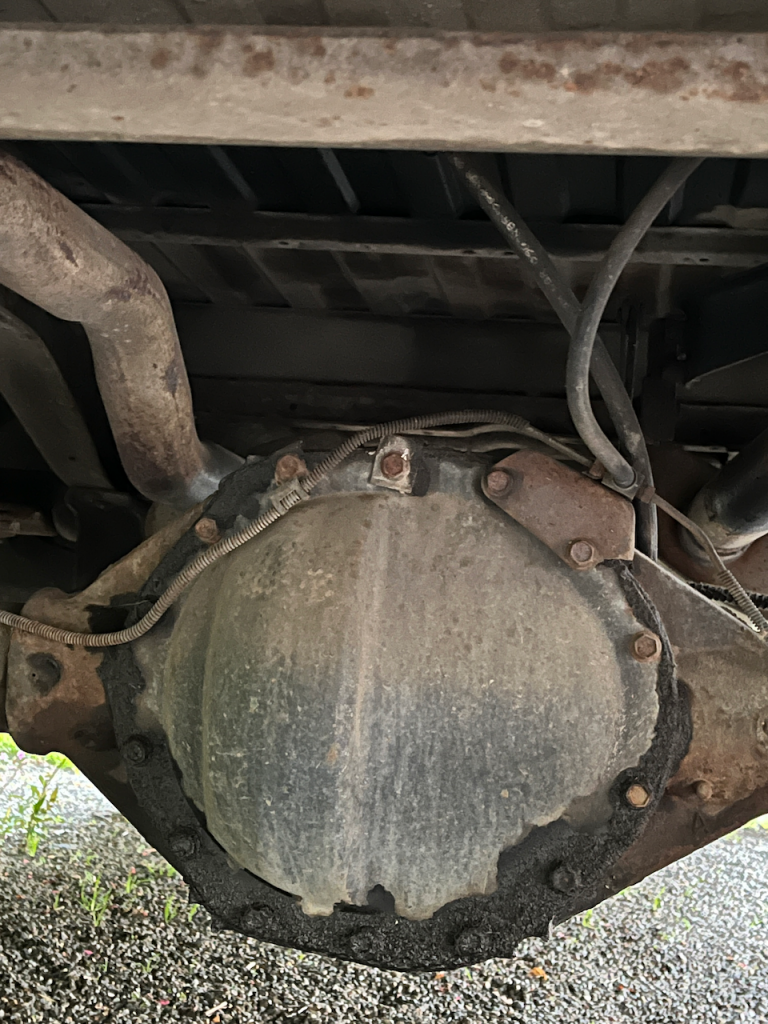

My 1985 GMC K2500 has the below. My counting skills allow me to guess this is a 14-bolt. The pumpkin, she's a'leakin just a bit, for how long no idea. Purchased from my boss 2y ago. Guessing just the seal but to be honest I've never worked on a diff. (Broken plenty of other stuff on mechanical things though doing routine maintenance :)). Where's the fun if you learn from your mistakes?
If this was a real easy "drain the oil, unbolt the bolts, buy a gasket off rockauto, reassemble, fill with gear oil" I'd probably try to do it myself. But if this is a "Well, you might have a dana model foo or you might have a corporate model bar there count the gears do the math see if the cover is rounded or less rounded" its going to a mechanic.
I do have a shudder while driving so something between engine and wheels is not happy. Open to your thoughts.
My concern with a professional shop is who the hell knows anymore how to work on the legacy stuff, they might just quote me an entire new rear end from GM at 4K rather than figure out the issue and charge me for a relatively minor service.
Thanks all!
Thanks all!
So it's likely a 14B Semi Float rear axle unless it's a Big Block truck then it got the 14B Full Float. As far as your shudder, the rear axle is the last thing I'd consdier. If the rear axle was having issues it's more than likley going to be a howling issue at about 40mph and faster. In your case, I know some 3/4 tons did get a 700r4 transmission. Torque Converter Lock up converter clutch is more common for a shuddering type issue. Next, I'd consider checking your engine, Tcase and transmission mounts. You don't have a carrier bearing since it's a K2500 Fo Buh Fo right? If you do, I'd be checking the carrier bearing also, but that's going to be if it's a Tuba Fo Drive as in 2x4 2 wheel drive. Keep us updated, what you find out.
EDIT: I didn't realize you're a newb guy. Welcome Aboard. Or I probably wouldn't have used the slang for 4x4 and 2x4. Hopefully you get it. :lol: Sometimes, we're not always upright around here.

Thanks for the info! My GMC is a 2WD with a 5.7L (350) brand new(ish) factory crate motor*, everything else in the truck has been around a while. TH400 trans IIRC.
Yes, new here and glad to find the forum. I'll post up when I know more whats going on.
* the PO's kids drove it but never checked the oil with results you might guess, he put in a factory crate then sold it to me
