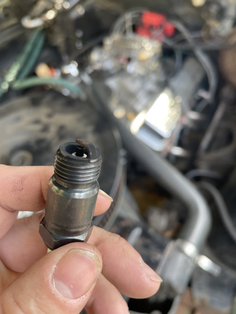

They normally are worse than this I cleaned the plugs up earlier but this is about 7 minutes of run time on them, it idles fine but then you give it throttle and it starts to miss real hard

Those don't look fouled. I would start with a compression test. Autozone rebuild is sketchy at best... you could have all kinds of wierd mismatched components in there. I would start with a compression test... they should all be within 5% of each other and more than ~150psi. Then I would look to make sure that my cylinder head casting numbers matched. Then I'd be looking at intake manifold or vacuum leaks. Then I'd be making sure the distributor is in decent condition. Have you already properly set timing and carb idle mixture?

Actually, the plugs don’t look too bad. If it’s missing under throttle, start with a through inspection of the ignition system. Remove the distributor cap and rotor, look at the tiny wires that go to the pickup coil. They are known to break causing intermittent no start of misfires.
start with the basics. Is the float set correctly? Is the choke opening all the way? Is the timing correct?
Run a compression test, hopefully the results are even. Run the test both hot and cold, ideally with all the plugs removed and the throttle wired wide open.
