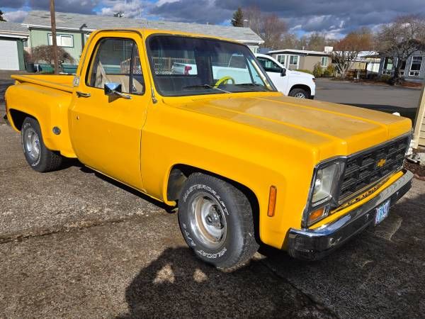

Here’s mine . Just bought some original steelies and trim rings for her . Looks much better
