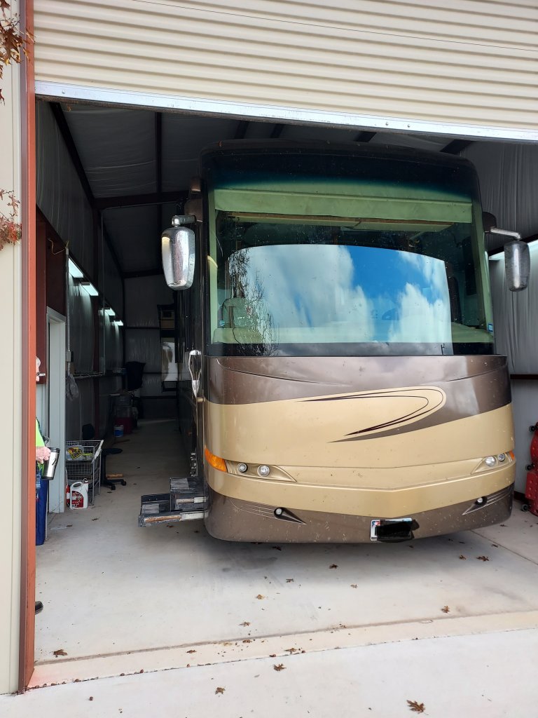

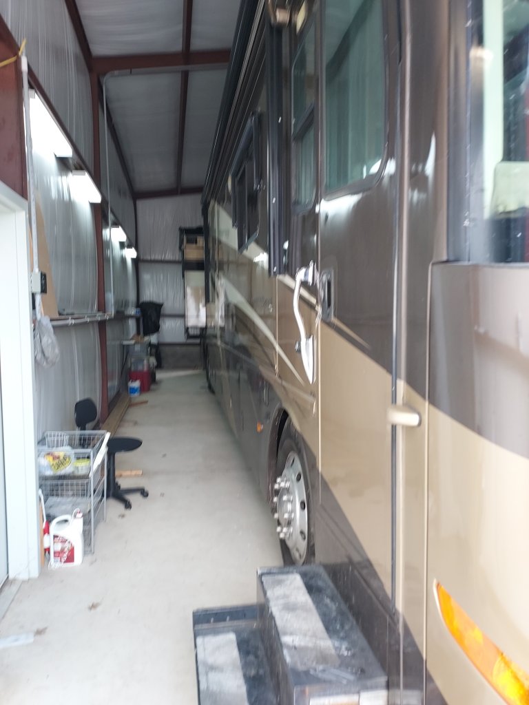

Lol, not a daily but wanted to post somewhere.
Helped Dad air up tires. It is very difficult for him to do now.
It is hard to give perspective of how huge this thing is and how space shuttle like it is with gadgets. 45' + car they tow behind. He took it to Alaska...

Kudos to your Dad for even getting in that monstrosity.......let alone herding it down the highway!!!
He likes a challenge, Lol. I'll have to write down his Alaska story. On the trip, found out washer/dryer he had installed still had hold down bolts on washer tub (so had to remove and reinstall), replace refrigerator through window, exilary water pump, winshield chips, shower again in Colorado (mouse chewed fitting)...

what do they dingy tow ? ...and that is some garage to put that bus like thing into.
Tow a Yukon. Yes the garage is the pad they used with a smaller RV while building the house. Then, sold it to someone who did the same 6 miles down the road. He then build the garage on the slab for new coach. He was a engineer, so everything is planned.
