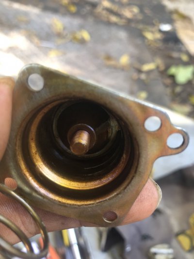

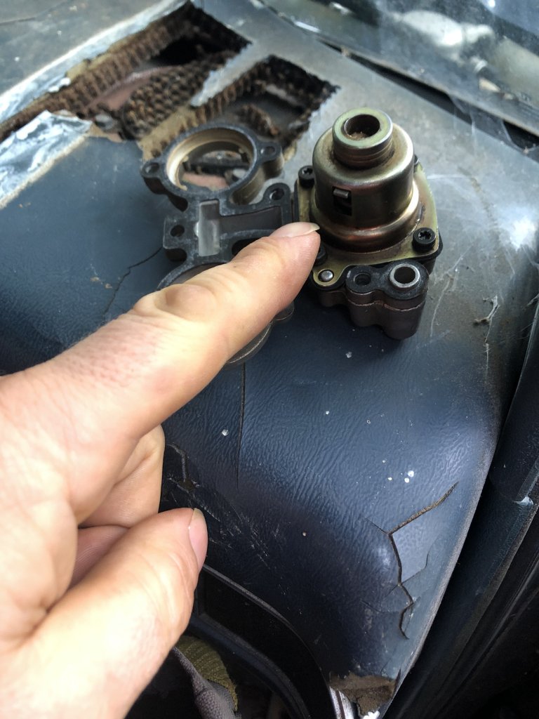

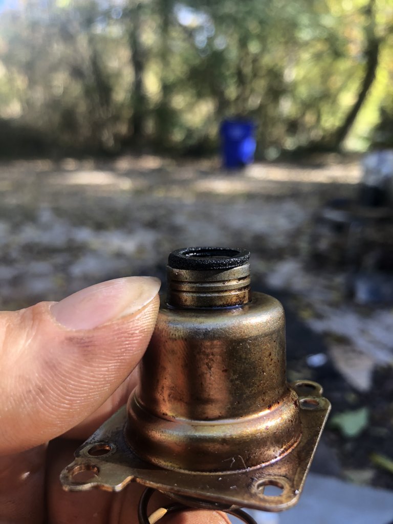

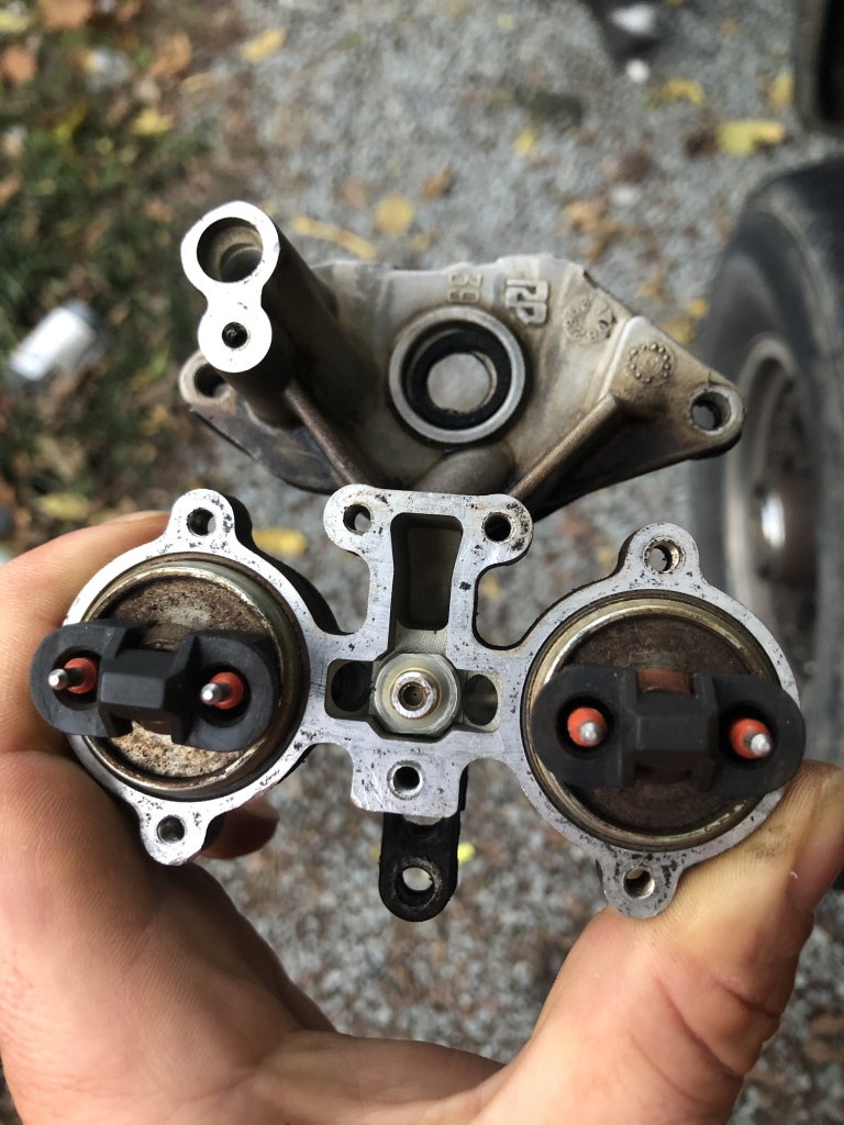

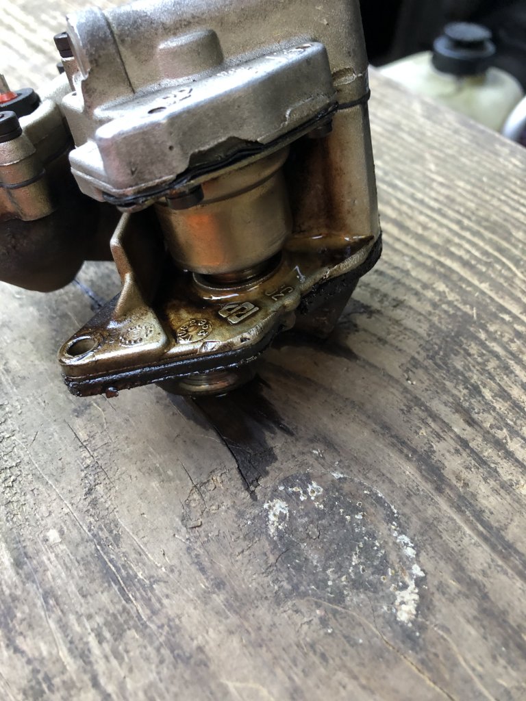

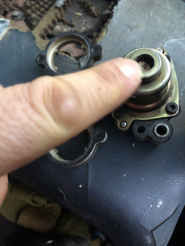

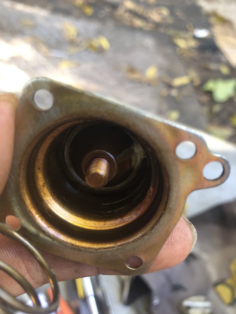

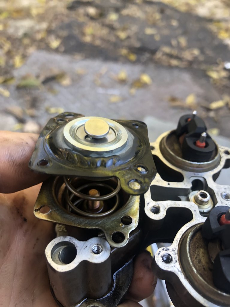

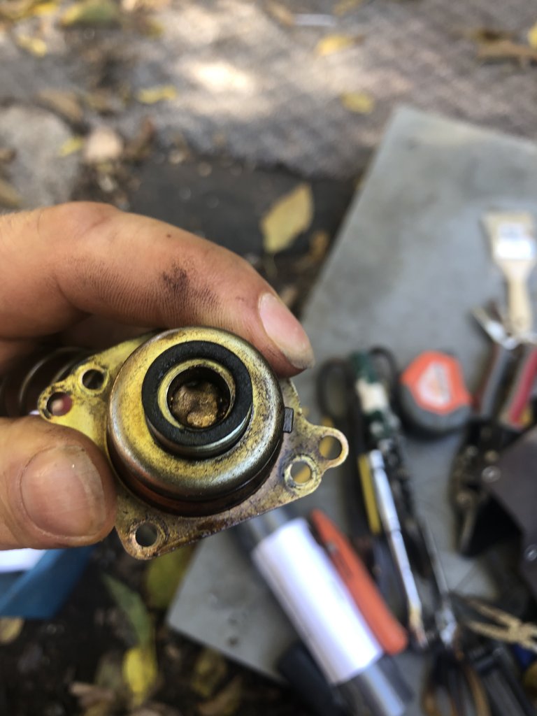

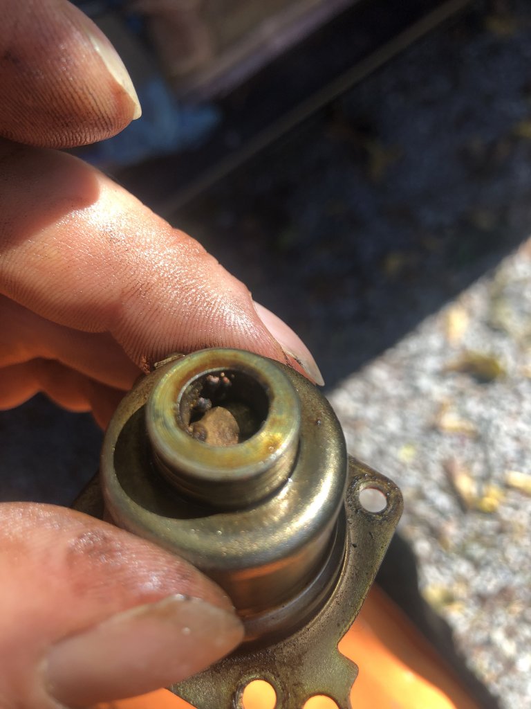

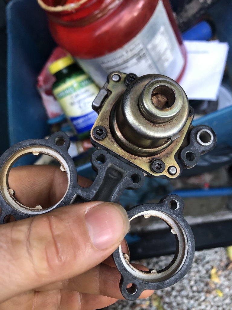

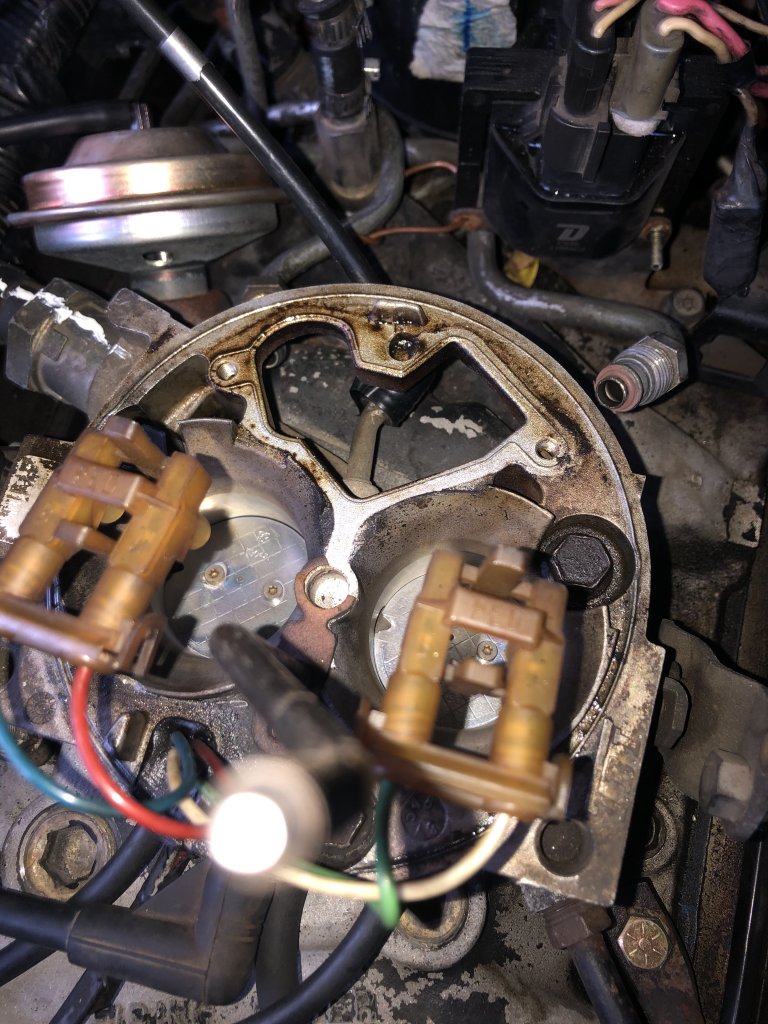

What is “iirc”. Thanks for the reply could barely get out the driveway can I just buy a new diaphragm or do I purchase the whole regulator thanks!Looks like it's leaking at the housing seal, which iirc, is the regulator diaphragm itself.
Are u saying it’s just the gasket?Looks like it's leaking at the housing seal, which iirc, is the regulator diaphragm itself.
It look like welding spots for the screwWow, that looks pretty nasty. Have you replaced the inline fuel filter yet?
The regulator is a well known point of failure on the TBI, but it could have been jammed up with whatever that junk is. I would maybe think of replacing with a high quality adjustable regulator like the Jet one on Summit and also replace your inline fuel filter.
Yes already replaced fuel filterWow, that looks pretty nasty. Have you replaced the inline fuel filter yet?
