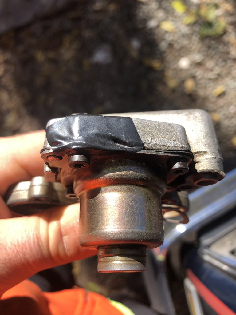

Should I put something to fill this in completely
From what I remember, that blob of weld is there simply to lock down the pressure adjustment.

I noticed a chip off the cast iron diaprham top. Quiet possibly was leaking fuel if that fails I’ll put gaco roof black silicone on it
