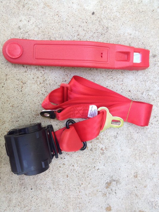

What are y'all using for seat belts.... OEM or after market.... I am in the market, my OEM are worn out and sags across the shoulder... I have been looking at the LMC, only has one retractor so the saggy won't be a problem. Only problem is price... Comes up to about 200 bucks.... FOR SEAT BELTS !!!!! Is there a mod for the originals or should I just bite the bullet.

I am thinking I want the single retractor.... Mine the shoulder strap sags as you lean forward and back and does not retract that well.... If there was a good fix, I wouldn't mine keeping mine, especially these after market seat belts are a bit pricey

What do y'all think of these

Well they exchanged them for the black ones..... They look a lot better, work a lot better..... Now I need to get my seat recovered

I have those seat belts in my second row of my Suburban. They are black, but same style and lock. They have worked well. I replaced the second row seats as they were getting a lot of use and seemed worn thin.
