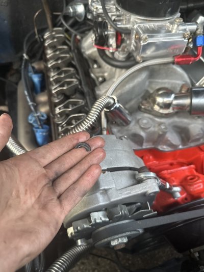

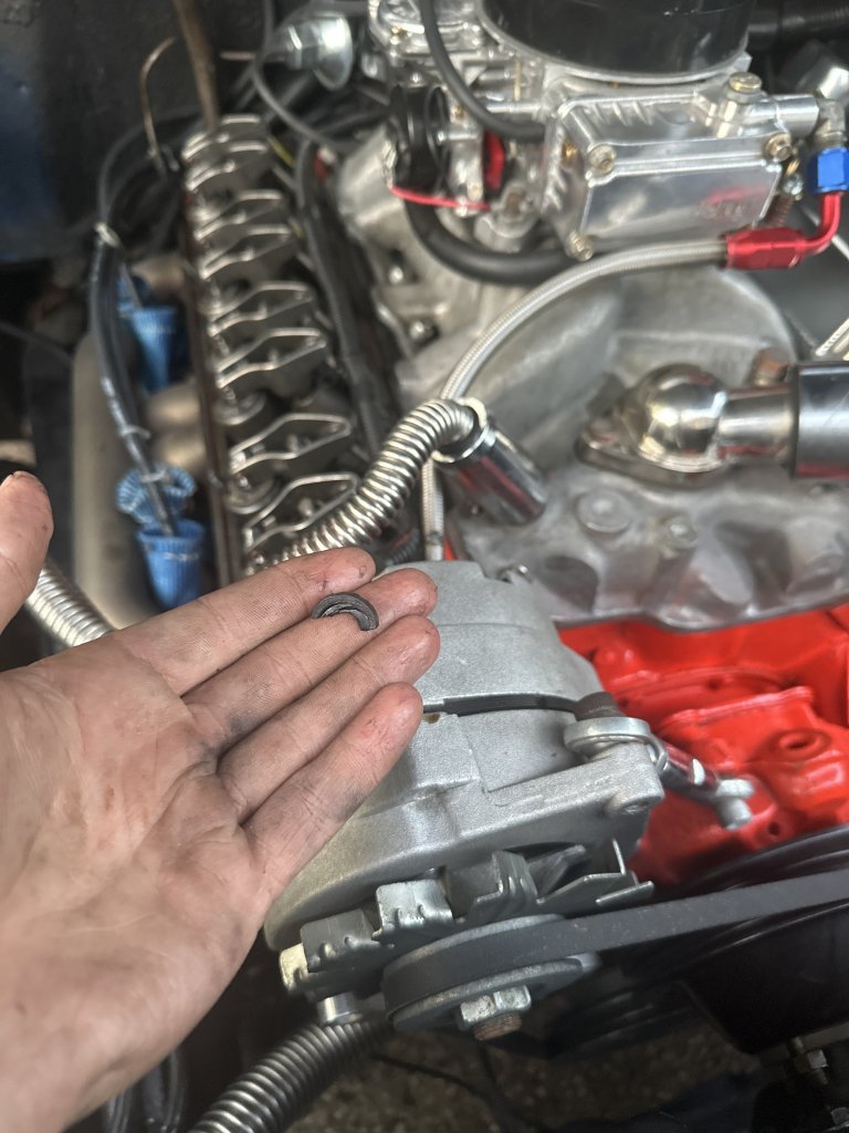

Okay going to re do it now, I just removed the fuel pump before I did the valves and a small circular plastic piece that looked to be broke in half fell out any ideas what it might be

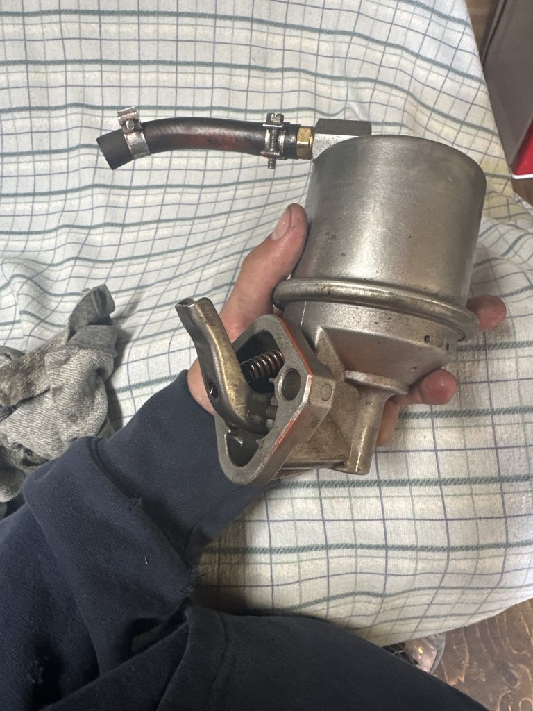

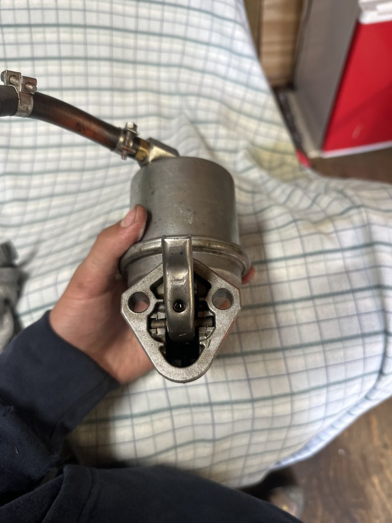

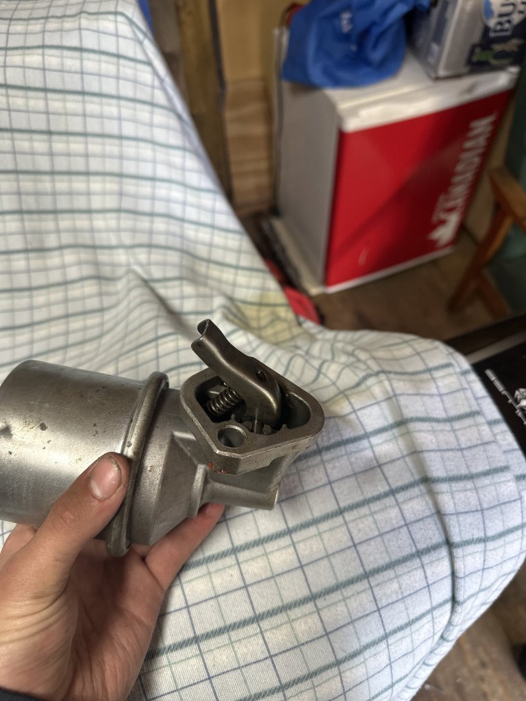

Looks like it's a piece from a fuel pump maybe. Get a pic of the pump arm.

I can't think of any plastic parts in the fuel pump but hopefully that is all it is and that would make the most sense considering that is the area where you found it.
