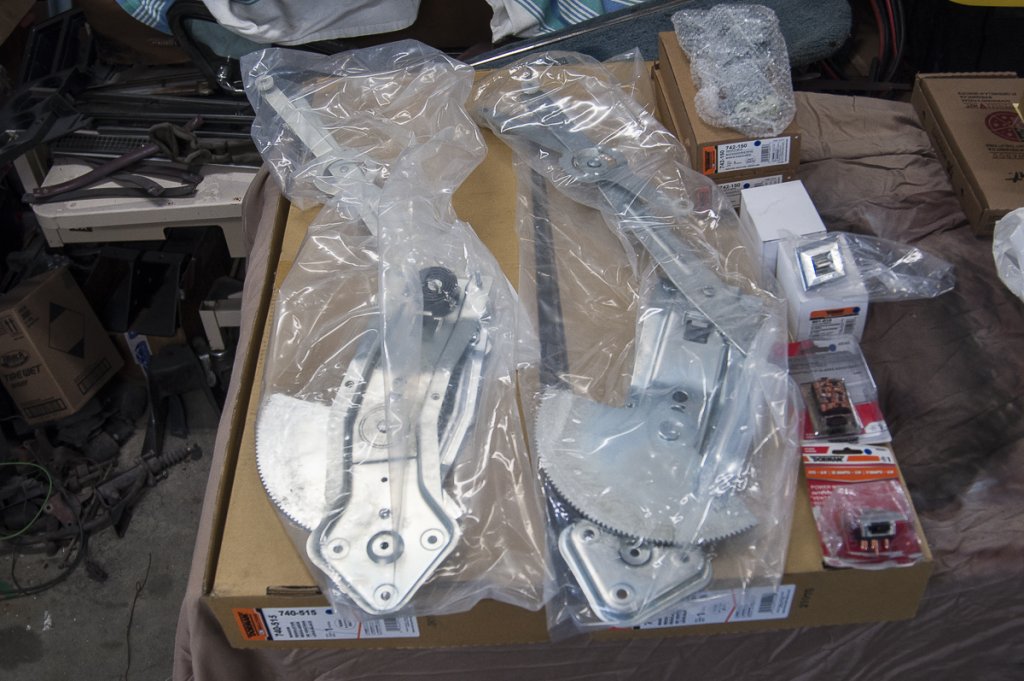

dorman are cheap and work great...don't kmow if you can retro fit on yours but...
