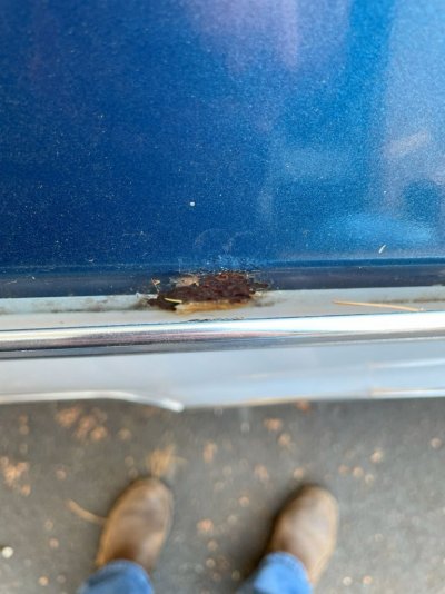

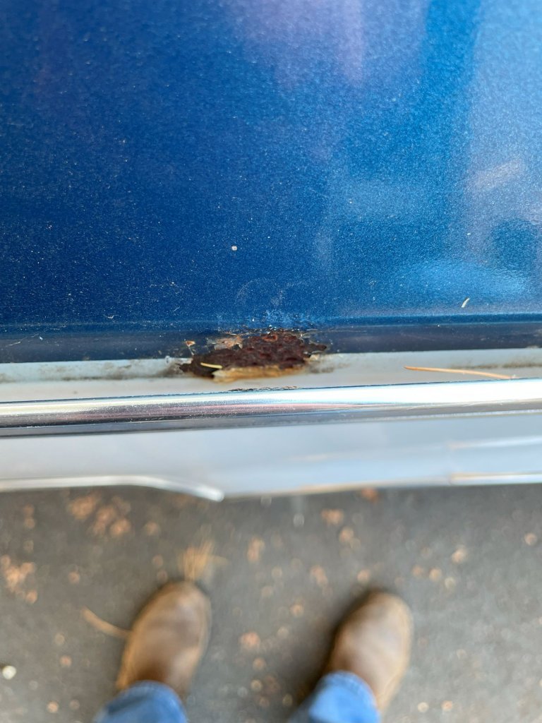

1980 Fleetside Silverado is rusting under the bedside molding/trim where the stickers attached to the truck. See attached pic.
I love the look but I hate the idea of re-attaching the molding/trim in the same way after repairing the damage. I vaguely recall someone on here mentioning he uses magnets to mount the molding/trim so that he can periodically remove to clean underneath, but I can't seem to find the post. I like the idea and I couldn't care less about resale or winning contests.
Is anyone using magnets or some other alternative to stickers?
Has anyone given up on the molding/trim and gone with a clean look instead?
Many thanks,
D.

Going off of that picture, you are barking up the wrong tree. That looks to me a fault of improper paint prep. What probably happened was the paint/primer did not adhere well, the double side tape pulled the paint off, then the rust formed over time.
Double side tape is the ideal method for attaching light weight body trim, to prevent rust. It's the reason why (well, one of them anyway) manufacturers switched to that method, rather than screws or clips that go into holes in the body.

That makes sense. The PO repainted the bedsides and my detailer opened my eyes to just how lousy the paint job was. So I wouldn't be surprised if the stickers lifted the paint. Though I only posted one pic, the damage is under nearly every sticker on that bedside molding. Many thanks for the helpful observation!

Yep, if they are all like that, my diagnosis is still the same. It's just poor prep work, unfortunately.
