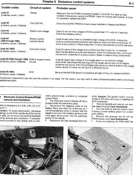

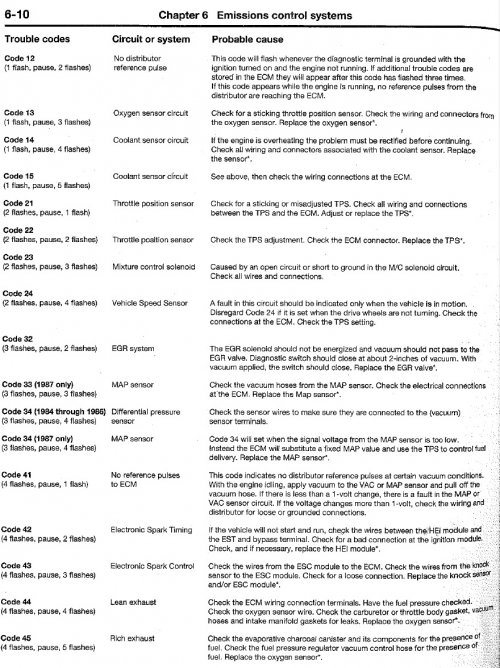

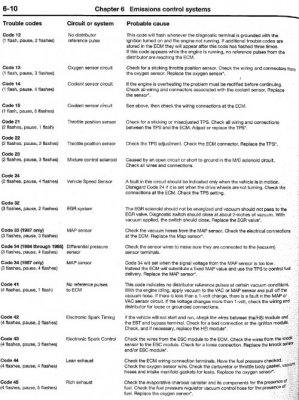

-Where's the IAC located? Facing the motor it is on the left rear corner of the throttlebody, screws in on an angle behind the Throttle Position Sensor.
-Where's the coolant temp sensor that feeds the ECM? That is the sensor to the left of the thermostat housing.
-Where's the vac line that feeds the ECM? Comes out of the front of the throttle body and goes across to the MAP sensor, square black box next to the TPS. Do not confuse with the EGR control valve which is mounted piggyback to it.
-Where's the diagnostic test port for reading the codes? Above the parking brake mounted to the bottom of the dash. You can use a piece of wire to get codes read using the check engine light - http://www.gmsquarebody.com/forum/showthread.php?t=6844
