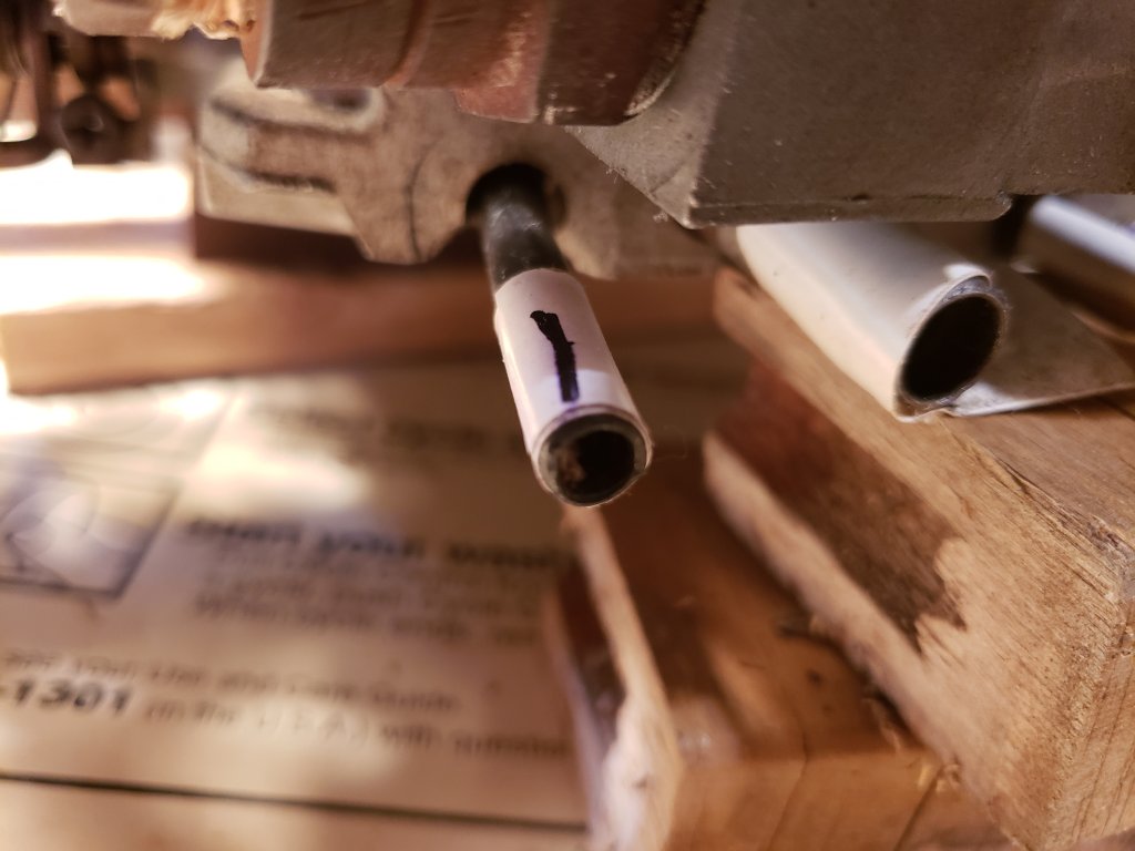

I just slipped a piece of hose over the jet head to turn it with and marked the adjustment when I got the best vac reading. I left the hose on.
Do you not have the springs on the back of the screws? Mine are way too tight to turn using a hose like that.
Mine have springs but they turn just fine, it has to be a tight fit, I put them in hot water to get them on. You can also put a little epoxy/glue in the hose and let it set, just be sure you don't glue the threads. I can bottom them out (by feel) and run them all the way out. Never had a problem. Like I said, I just leave the hoses on both sides for easy adjustment.
