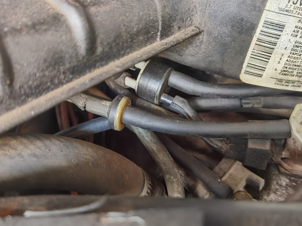

well i threw an eye on the thermal vacuum switch and look at this little moth******** hitten under the fresh air snorkel
those vacuum hoses are crunchy like cereals

i know, but i can imagine how this hose broke. i changed the fuel filter too, came to my mind when i saw this crack.
it's realy close and could be the mystery but i will change the ignition parts anyway and tomorrow i will by a couple of feet vacuum hoses and change them too.
the car is 37 years and if those are still the original ones a change can't be so wrong even if its not the problem but it may safe me from a headache in future.

That’s the likely culprit for the behavior you are describing. I would do a quick check on all the vacuum tubing. If the rubber stuff is that crunchy, the plastic stuff is likely brittle too.

Quick cut off 1/2 inch or so then re-install it and check it. If it fixes the problem then you got that one problem fixed and buy all new vac lines.
Then recheck all the wires, cracked plugs under the rubber insulators, cap & rotor, and would check to make sure that the distributor did not move on you also.
Just my way of thinking...
