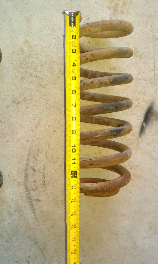

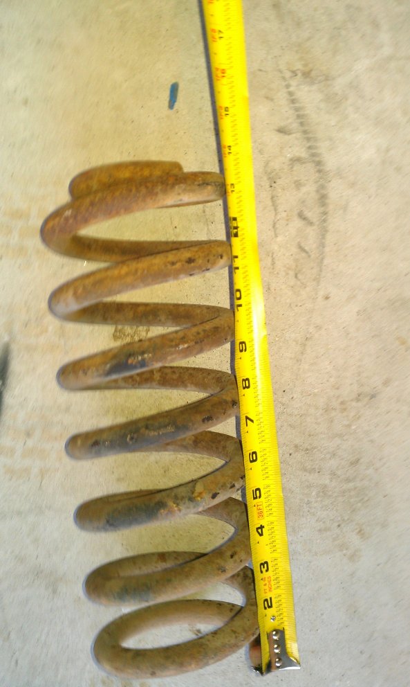

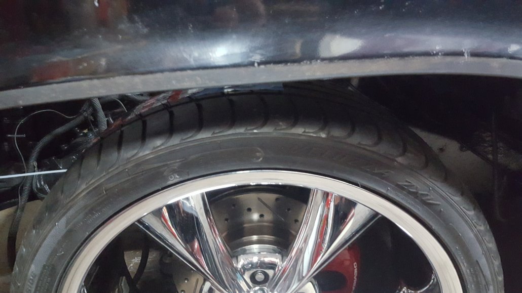

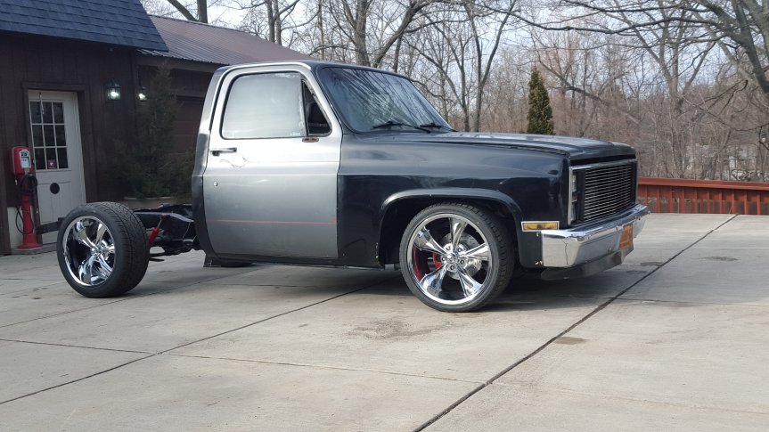

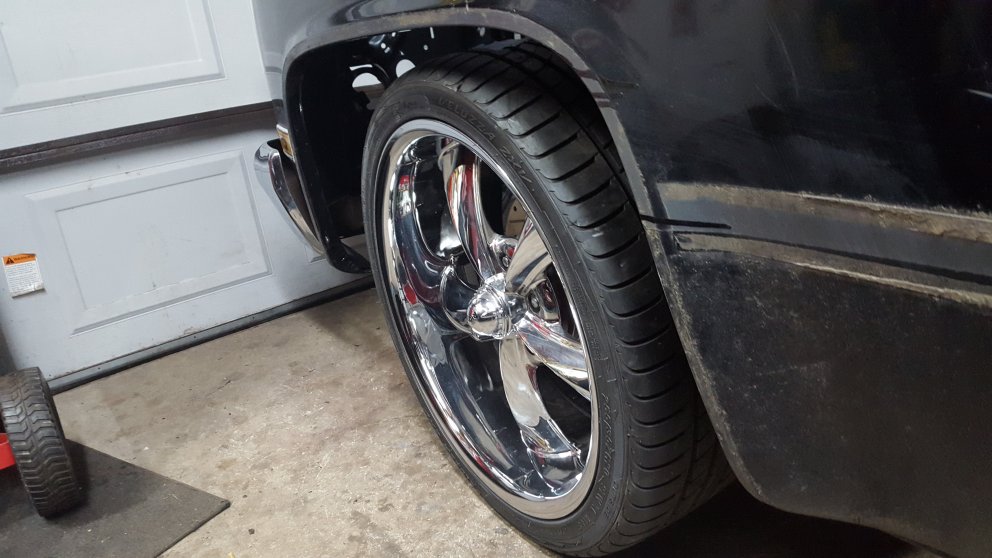

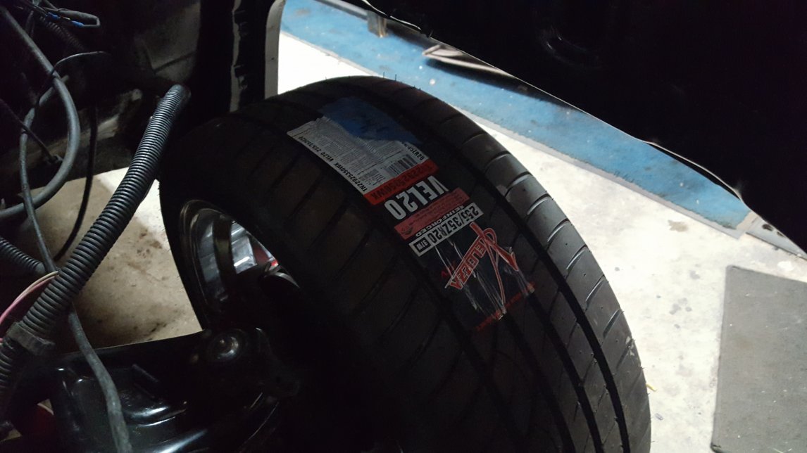

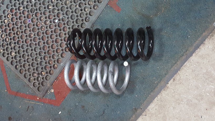

Jknight your right the previous owner cut the front springs pretty good before I cut them. I bought the new ones and the drop coils so I can compare size differences. Of course the drop spindles where the wrong ones I had to send back immediately. So I took the new ones and clean cut them one full ring off and place them in the truck.
The truck sits so much better now and starting to look awesome! But then I have that question can I make it lower seems like I have some room to go lower. But again I don't want to take to much off lol and go back again.
What is your guys input one more full ring will make just low enough before it hits fender lip? Also will the new front suspension settle a little after a awhile and lower itself a little. Also will the bed add weight in the back and make the front t go up or down in height? Lol here we go again with the questions sorry guys.
Overall I really enjoy this project!!!
I'm a little confused, in this post you stated you sent back a set of drop spindles and in your original post you stated the truck has drop spindles. What spindles are on the truck now?
Also, are the motor and trans in the truck?
You don't want to cut more than one round off the stock springs, that equals a 2in spring drop. If you go more than 2 1/2in spring drop you will run out of alignment bolt to correct the camber.
When you add the weight of the bed it won't lower the front a noticeable difference. It will lift up the front bumper slightly. As the rear lowers with the weight of the bed the bumper will lift up with the front wheels being the fulcrum, if you get my point.
My bad I was trying to reply to this post when 2 of my kids where going crazy around me lol.
So let me clear this up. The truck has 2 1/2 drop spindles on there with drop shocks. Also I took the a brand new spring coil and cut off one full ring. I order 2 sets of coils one factory and the other drop coils for a 1 inch drop. The drop coils came in and where the wrong ones and had to be shipped back.
So I used the new ones with a full ring cut. overall seems like I can go a little lower. What would be my best option? The truck is compete accept bed. Sorry about the confusion I'm dad during the day and truck builder at night

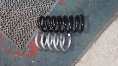

It does appear to be slightly higher than a typical spindle and cut coil drop by about an inch. The top of the tire should be almost even with the fender lip, note the third truck in the pic with the 20's.
Have you rolled the truck out since you let it off the jack? When the tires make contact with the floor as the jack is lowered the tires will push against each other leaving the suspension in a bind, you need to roll the truck 5 feet or so to relieve the "bind" or you can jack up under each control arm one at a time to relieve the "bind".
Another thing to check is to make sure the top of the springs are seated correctly. The top of the coil is "D" shaped, The inside of the spring tower is also "D" shaped so make sure its lined up.
Double check the coil spring part # you ordered, You could have possibly ordered a 1 ton or BB spring.
Cool thanks for the information I'll double check on the coil spring part number but almost 100 percent sure it's the right one. Also the top of D part of the coil is correct.
That last part about the truck moving around was going to be my big question. I pretty much set the springs and dropped the truck on the ground didn't have a chance to at least roll it out of the garage. Also we got slammed with a foot of snow tonight and another foot tomorrow. I'll update on the progress thank you again for the help!

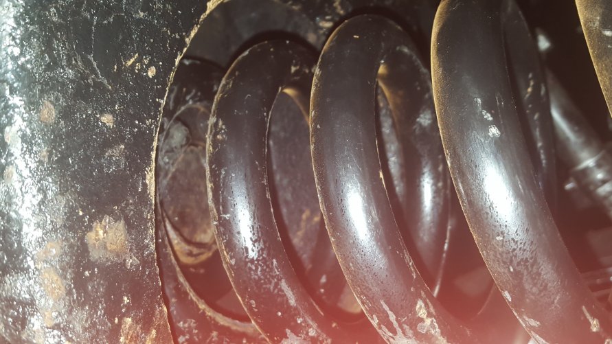

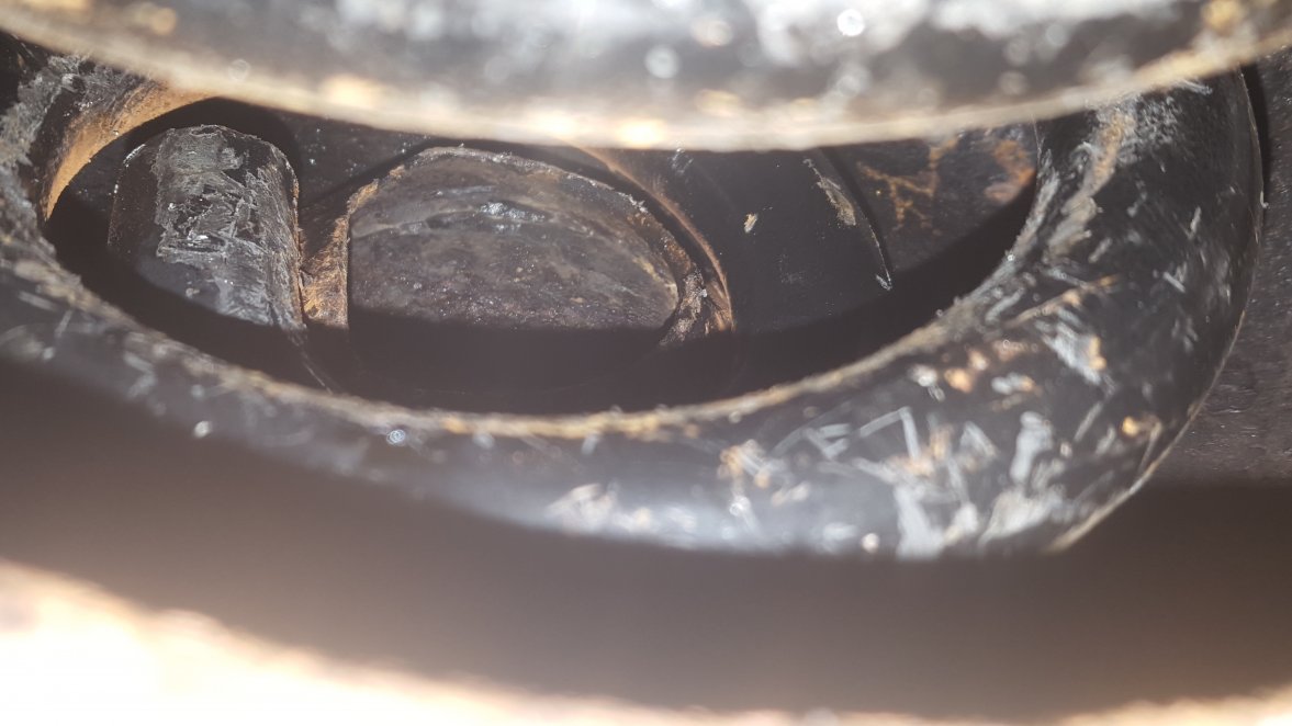

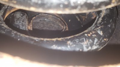

Just and update on the spring I jacked the truck all the way up to see if the spring was line up with the D setting and it looks correct to me. But I noticed it didn't go all the way to the top I noticed the backwards C part of D was around the last part of the tower housing but the tail end of the D didn't go flush to the top of the tower. Sorry that might sound confusing I took some pictures hopefully that will help. Otherwise to me it look pretty normal to I haven't yet rolled the truck out so the suspension could settle or in bind we been getting slam with snow.

Looks OK from what I can see.

Here's that coil spring spec's let me know If these are the correct 2WD front stock coil spring package for my truck. According to the compibalilty cart they.

The only other 1/2 ton spring is the 6454 which is stiffer, looks like you have the right one.

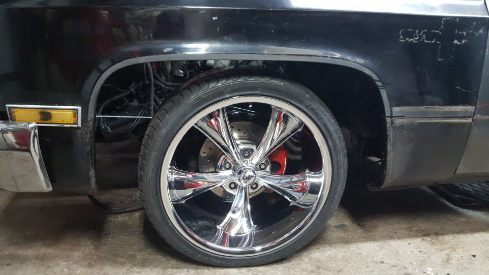

Well I moved the truck around a little bit and seems like the front end went down a little bit but not enough where I want to be. My goal is low as I can go so where I want tor be is fender lip and almost rubbing the inner wells in if that's the case I build my own inner fender wells.
So do u recommend a 2 inch drop coil?
I already have 2 1/2 drop spindles and drop shocks.
I figure I'll just do it right and order the right coil for the project.
Thanks again for your help

Can you set the bed on and any other part that is missing on the truck that has significant weight?

The bed is at my other shop still working on the noodle bed. I think the bed weighs about 500lbs you think that weight can adjust the one inch up front? I can bring home and try it. what about 2 to 3 guys standing on the back side will that get me and good idea if the front drops to where i want it. thanks again for helping i apperiacte your time shawn
