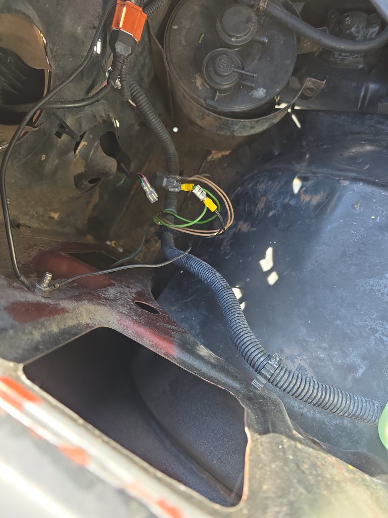

Hello guys, I have a 82 c10, I installed 4x6 ebay lights. I have wires everywhere in the front. I have 2 greens, 4 black grounds. 2 tan wires. The issue i am running into is....my right turn signal works at the rear. Running lights work when I turn them on all around. Now the problem is when the truck has no running lights on my left turn signal does not work. When I have the lights on it does not work either. Neither one of them do. Thank you for your time

Wiring diagram on this site will help solve your issue. Clean all your connections, and grounds, and replace deteriorating wire and connectors. Better information and pics will help others help you.

Thank you guys so much, ill try these things out tm! For the meantime ill showll yall what I'm working with
Can yall let me know if something looks off!
