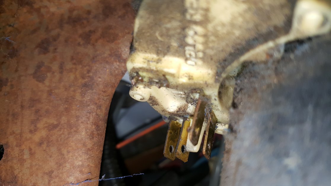

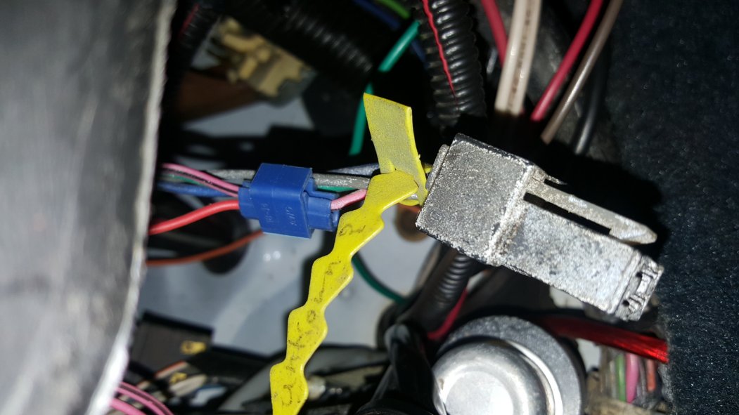

Thanks for the reply. I got up there and there is certainly nothing plugged into it... but isn't that was gives juice to the starter? I found a male plug that's not going to anything under my dash, but I'm not sure if it's the proper plug or not. Took pictures, maybe yall can help me identify.
On the power to the starter solenoid:
Sometime ago (maybe late 70's or early 80's) the neutral safety switch was abandoned in favor of a mechanical lockout system in the upper steering column. There is a plate (maybe a sector plate) that has two slots. These slots align with the rack. The rack is what moves the ignition switch (via a rod) to it's various positions. The rack moves up/down within the column according to which direction the key is turned. The two slots will not allow the rack to move the ignition switch downward to the START position, unless the gear shift lever is in either P or N.
From then on the purple wire to the starter was a straight shot from the ignition switch to the S terminal on the solenoid - no color changes and no safety switches. If equipped with a manual transmission - then it comes out of the ignition as yellow and changes to purple after the neutral safety switch.
On the reverse lights wiring/switch issue:
When I initially read your post I did some research - mainly to provide you with the color of the wires that should be connected to the column mounted back-up lights switch. They are LT GRN & DK BLU, by the way.
Anyway, I was looking at wiring diagrams for the reverse light switch. When I found it I was surprised to see that incorporated into the same switch body as the back -up light switch was a P-N switch. I was interested as to what that switch was for. I looked at all the dwgs in 1987 & 1988 and all it ever said about the circuit was "used with auto transmission only". I did quickly find out that it is an input to for the ECM but never the actual purpose. But I was determined to find out. Went next to the service manuals and again the only explanation was that it is used "with auto transmissions only". I finally found a brief and rather vague explanation of it's purpose in the Driveability and Emissions manual. Here it is - and before I forget, the leads to the P-N switch are ORN/BLK & BLK/WHT:

Chengny, you are the MAN. Thank you for sourcing those documents. Found the wires, rewired the plug and finally I've got fire to the reverse lights! Do you have any idea what that other plug I posted is for? Everything seems to be working, so I really have no idea what it's to.
