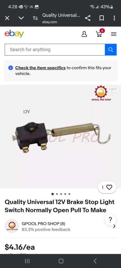

Use a spring loaded pull type switch hook it to the 1st reverse shift lever at the transmission. Use something flexible like fishing line as your pull wire so it doesn't bind when you go to 1st.

Going with a street bike reverse switch and spring setup. Just need it to be functional for 10 mins. Friend of mine who has a few Model A and Model T's use these all the time and swears by them.
