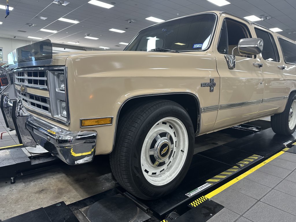

Howdy all!
I have an 85 454/th400 suburban and my first travel trailer pull (6miles in) caused me to puke out new tranny fluid out the vent tubes. The fluid came out burnt and black so I’m guessing the clutches are shot. Should I rebuild this thing (much cheaper?) or swap to a 4l80e (new shaft, controller, etc?)?
The turbo 400 looked good on the inside but I wonder if being 40 years old made it take the cake when I towed with it?

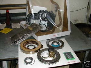

Nick,
Do you recommend a heavy duty tow rebuild kit and a shift kit?
This one looks good:
NickTransmissions
Aug 3, 2023
537
1,119
Las Vegas
Nick
R10
Nick,
I normally dont use shift kits in TH400s and 4L80Es as they arent necessary. Dual feed the direct clutch internally, rollerize the output thrust flange, install the Sonnax TH400 boost valve/sleeve and spring kit, drill the high clutch feed out per your converter stall speed and desired shift firmness. Keep both accumulators active and reinstall all the check balls.
I would also incorporate high energy clutches into the build, though the stock clutches are fine for most mild applications. Install a Chrysler A518 forward clutch snap ring in the intermediate clutch pack in place of the factory TH400 snap ring. I usually end up using the .106 thick version and with three factory steels and clutches end up with .040-.050 clearance in that pack which is ideal, IMO.
