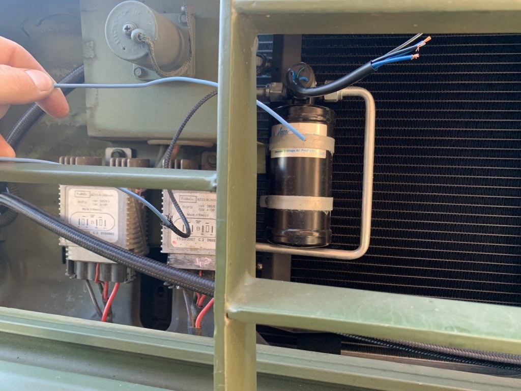

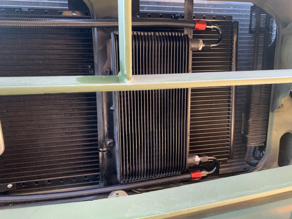

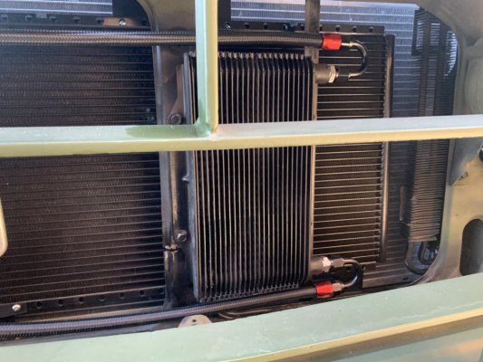

You are correct, now that you mention it, the Duramax did have the Mechanical fans. I love re-purposing cheap parts. Many folks spend +$1000 on radiator and Fan setup and certain level of car build deserve nothing but the best but us every day guys don't need all that high dollar stuff. I also used two PWM controllers that I robbed from 2ea. 05/08 Ford Fusions to control the fans. $10ea. and a used heavy duty Trans Cooler from a 98 Suburban with a $50 Trans cooler line kit from eBay
