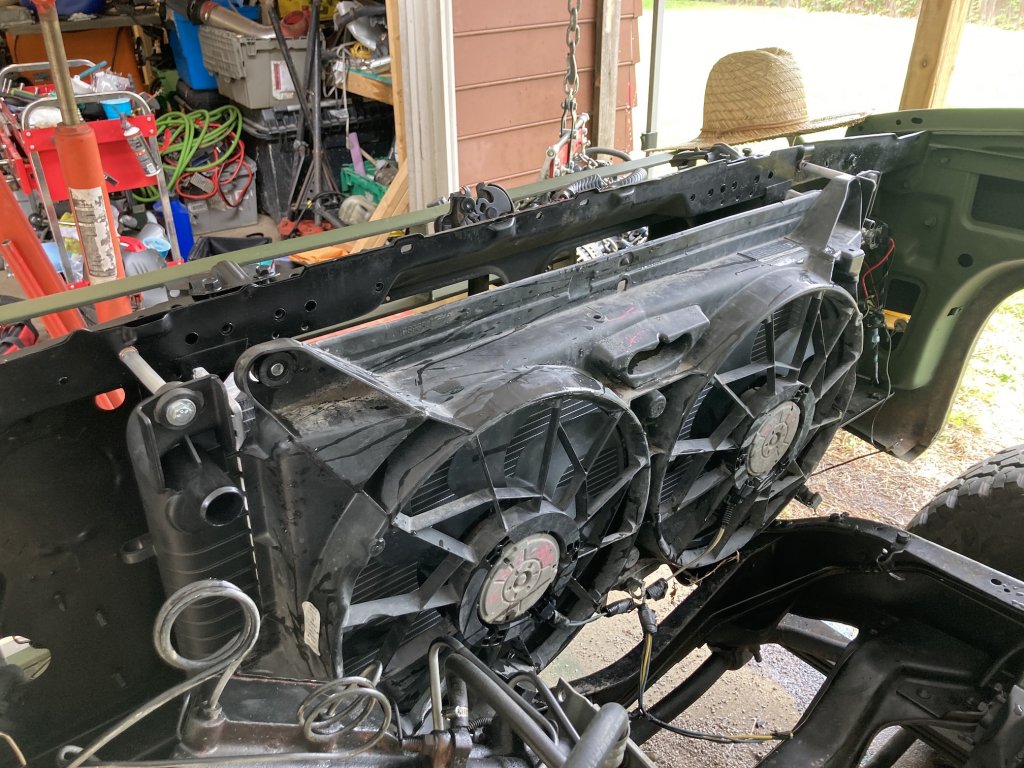

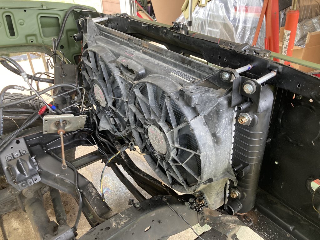

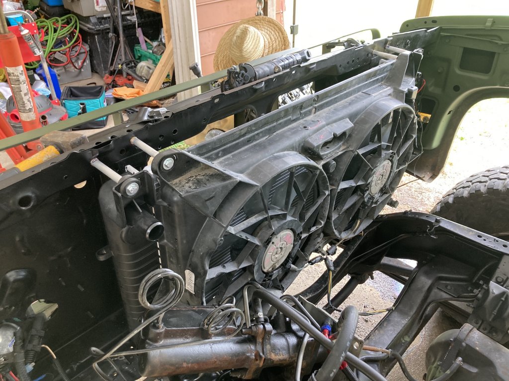

I put in a Radiator with E Fans from a 2008 Silverado in my K30. The Fans I got at a Pick and pull and the radiator I bought new for like $70 bucks. Made some spacers and a Rivenut gun.

I did similar. Finally got mine all in using the stock upper mount and modified the lower mounts. It’s a factory 97 K2500 454 radiator and 2011 K2500 dual electric fans. Fits great and its literally the biggest radiator you can possibly fit in here. It is right at the AC lines on one side and the air inlet on the other side. Stock 350 upper radiator hose and the stock 97 454 lower hose fit perfect.
I also used the factory GMT-400 windshield washer tank and aux battery tray and the stock GMT-400 overflow bottle mounted on the drivers side wall where the original squarebody washer tank would have gone. The radiator was too wide for the stock overflow tank to fit between the main battery tray and the radiator.
Looks great, did the fans come out of a Gas or Diesel 2500?
