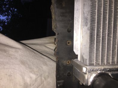

Yeah I called pull a part and some other place and they didn't have an older truck.. I have a few pictures of the problem I'm having. I have 2 brackets that it's sits in but when my radiator is in them it isn't sitting flush with the top. Here's the mount, it just seems like there's a bracket or something that would make it 3 or 4 inches taller

4,560
3,813
Do you have those on the top brackets as well? I've got one on each end of the radiator. If you have those and it's wicked loose like you say, I suspect someone just grabbed a radiator from a different vehicle that isn't the same size.

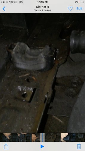

It's not necessarily loose, it's just not tall enough. When I got the truck he told me it needed a radiator cause his had a hole in it. Upon inspection , the radiator he had was too big for the bottom bracket and had punctured a hole in it .so I ordered a new one online ( I'm assuming it's oem) it fits into the bottom bracket without a problem scrubbing or anything like that, but now it won't sit flush with the top.

4,560
3,813
Should look like this and mount on the edge of the tank (think thats what it's called....not a radiator pro). Top and bottom are in that location.

4,560
3,813
You may have gotten to wrong radiator. You could verify with the vendor that you got the correct one.
As a temporary fix, you could find some hose and cut it to length, fill the inside of the hose with cut pieces of extra hose. Just make it thick enough to take up the slack. Or roll layers of duct tape over a smaller hose until it's thick enough to secure it. LOL again this is only temporary.

Update: an old friend of mine has a 78 sitting in a field behind his house because he totaled it last year. So I went and looked and there are no brackets whatsoever on the bottom. Just 2 rubber pieces that the radiator sits on. So I took those and the top piece off of his shroud . It's long enough to go across the top of the whole radiator and the corners sit square in 2 more rubber groves. "Almost" fit like a glove, just had to do a little bit of tweaking. She's alive! And out of gas.. Lol
