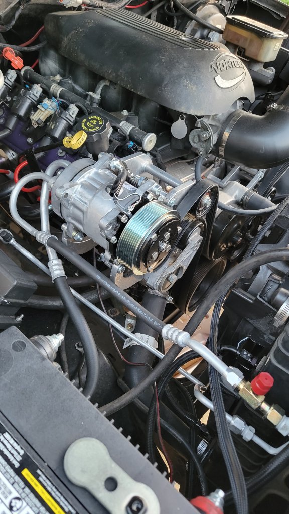

c5killer
Jun 14, 2023
6
Sean
1991
V1500
Gen III 6.0L org. 5.7 TBI
Here is my R4 to Sanden 4864 conversion.
You will notice my burb has been LS swapped. I had the ICT billet R4 bracket. Instead of buying a brand new bracket for the Sanden unit, I elected to buy the Dirty Dingo conversion kit. Of course I had to tweak some of the spacers for the rear mounts, but no biggie. I used the spacers from the ICT kit. According to Dirty Dingo, It should ride in the middle of the 8 grove pulley. They also said i will need a 1" OD larger belt (on order). I know the high line looks tight. I plan on adjusting the metal portions to give it a little more relief. I still need to wire in the connector, charge the system, get my vacuum lines sorted out and I should have A/C!! I will update when complete.
I have to give a shout-out to this forum and yevgenievich for all the information he listed in this post!! Links for the parts I use are listed below;
Sanden 4864 - https://www.autoaironline.com/ac-parts/sanden-4864-compressor-1940
#8 High side discharge port - https://coldhose.com/products/8-high-side-inline-discharge-port-r-134a-16mm?variant=35531745427616
Dirty Dingo R4 to Sanden kit - https://www.dirtydingo.com/shop/product_info.php?products_id=1622
