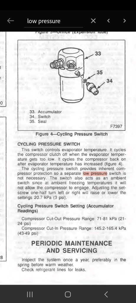

from the service manual on which way to turn the switch
