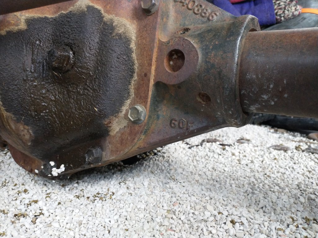

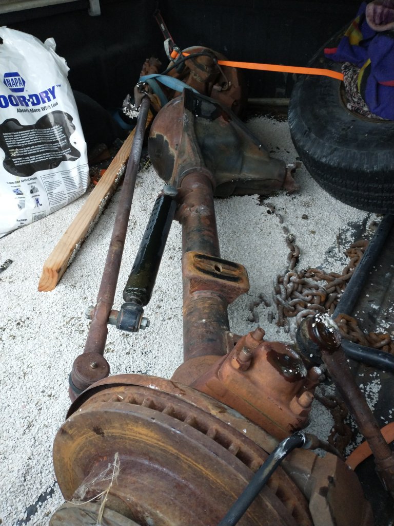

640 miles round trip, and I got the dana 60 i was searching for, but when I got there he would not budge and had changed his mind and needed to keep the U-bolts and the plate, but I was able to get the steering box.
now I need to find some u-bolts and top plates, any suggestions

Sway bars are the same and so are the spring mount plates for a D60. I got my parts from ORD. Remember the D60 only uses 3 U-bolts and 2 studs. I also run ORD's sway bar disconnect.

Ubolt plates absolutely do not interchange between a D60 and other axles.
Off Road Design sells some plate steel ubolt plates with a provision for the sway bar. Not only will these work but you’ll notice that the application is only D60’s, they offer different plates for smaller axles.

I emailed off road design today and asked them if the plates interchange, they said they do not interchange, I am going to order a set of them tomorrow
