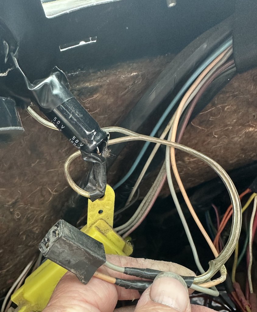

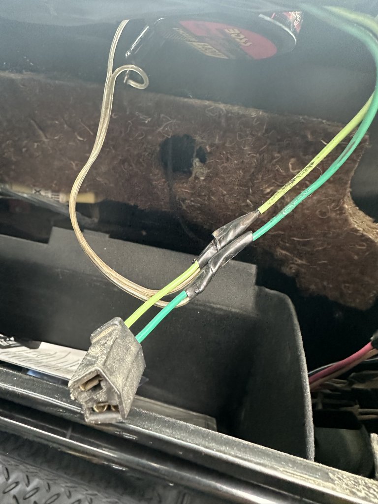

Fwiw, anyone who wants to keep the oe wire and connectors in tact, you can buy adapters from the GM plug to double spade connectors very cheap.
I left all the in-tact OE wires and just ran new speaker wire though.

Where do you buy these aftermarket connectors for the two front speakers??

Amazon has them.
Probably other car stereo suppliers as well.

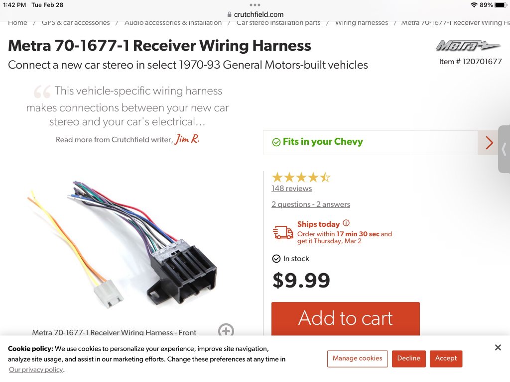

Crutchfield sells these: Metra 72-4565 The link says free, but only if you by speakers from Crutchfield. So $10 for a pair.
Crutchfield (Click)
After clicking the link, click were it states parts needed to install in your truck.

Tear the connector body off of old junk Delco speakers, solder the new wires onto those connectors. Plug them into the factory connectors, cheap, no hack install.

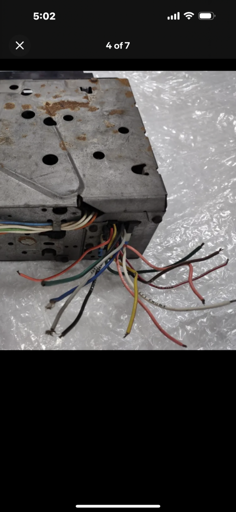

On the old radio I bought it has wires labeled like ‘right rear’ and beside that one has ‘right common’
Same for left rear, front right and front left, beside each has a ‘common’ wire is this common wire positive or negative

Common would be negative. If a speaker is connected with the proper polarity, the speaker cone will move out. If the speaker is connected backwards, the cone will move in. If you have one speaker connected backwards (out of phase) it will cancel about 70% of the sound. Massive difference in sound quality between the three options, correct, reversed polarity, out of phase.
The capacitor on the dash speaker alters which frequency range is reduced to the speaker, probably trying to limit the bass to the small speaker. It's the cheap way of faking a crossover for the twitter/mid range separates.
If you know how to solder I would eliminate future problems by soldering the wires directly to the speaker terminals, use 16ga wire for the speakers. If you live close to the ocean, make sure you use oxygen free speaker wire. Be sure to use 60/40 rosin core solder if you decide to solder.
