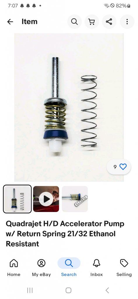

Here's that number you gave. Says a size 21/32" I'm guessing it's probably the correct one. Maybe someone else will see and confirm.

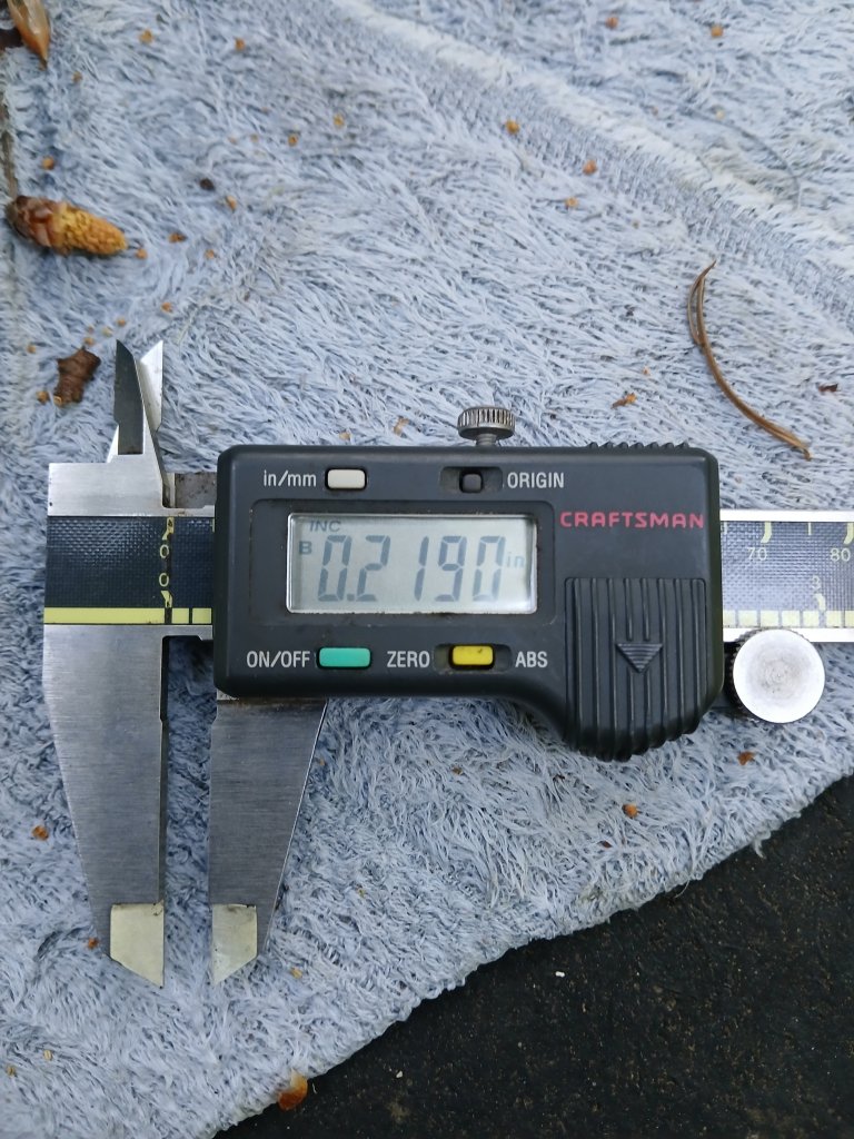

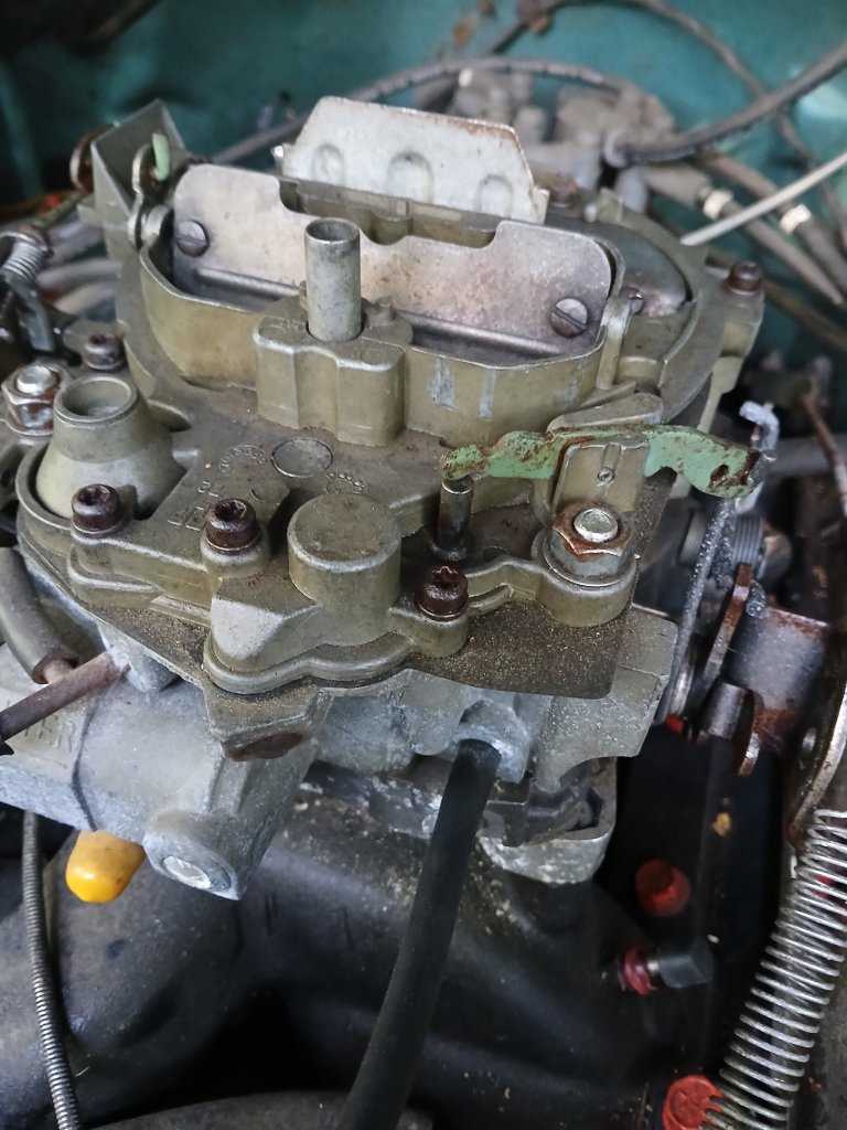

Here's the style carb and the measurement I got. Seems like a different size?
11,989
19,066
Similar to a kit, aren't they carb-specific and can be ordered by the number stamped on the carb?

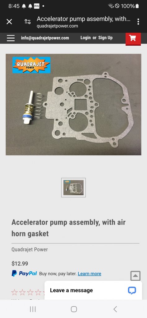

I've been looking on there site and I gather length seems to be the biggest difference.
I found this kit. I like how it has the gasket too because im concerned aboutripping it. (picture) and it skips over my model number 17085212
75gmck25
Oct 13, 2016
2,448
2,502
Northern Virginia
Bruce
Just give them a call. I think the longer ones are supposed to provide more volume, but I may be wrong.
The silicone seal is what you need, versus the original rubber seal.

I just got one from Quadrajet Power. I emailed them the numbers on the Carb and they sent back the part numbers that fit my carb.
Fast shipping when I ordered.

I think I'll give em a call tomorrow and see what I can find out. Thanks everyone
