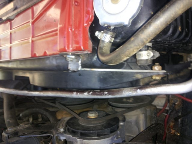

Ya im going to put my aluminum one back in after I clean it out with some clr..that rad sat for awhile it looks clean but who knows if the rods are clean

Put aluminum rad back in just hosed it out. And its raining out side ... ill see if it made a change in temp on monday..

Update radiator was clogged up changed it back to the one I had in it before runs down the road fine now. Morning time when its cooler it runs on the 210* mark where it always ran. Afternoon it runs about in the middle before the next mark maybe 217*. The gauge reads 210 but lazer gun says 195*on t stat...man really wanted that rad to work out oh well..
Thanks again to all that replyed
I keep changing things on this truck yall are always there to help out
Its much appreciated

Ya I thought about it but it has maybe 8 -9 tubes sealed off so its been repaired some fins are banged up too I dont want to keep worrying about it getting hot.. ill buy a new one in the future maybe. Plus with the high flow pump im going to put on it with the serpentine setup it should help it stay cooler too.. thx
