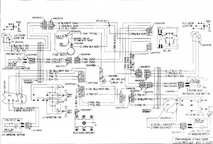

The power window and door locks are separate circuits but run on the same loom. The door locks could be a couple of things.
1. The easiest is to get new switches. I did this and my LOCK feature worked again. They are flimsy on the inside and contacts wear out in them.
2. It could be the relay that is used in the lock system. They are hard to find under the dash, and hard to find at the parts store.
3. Window could be motor or power to motor... or maybe even the switch.
Wiring Diagram for you...

or is it more simple such as a lack of power to the actuators? if so what should i check?
There should be power available at the jack indicated (E) in the dwg below. And there should be an orange wire plugged into that jack. The orange wire is the hot lead to the power lock system.
