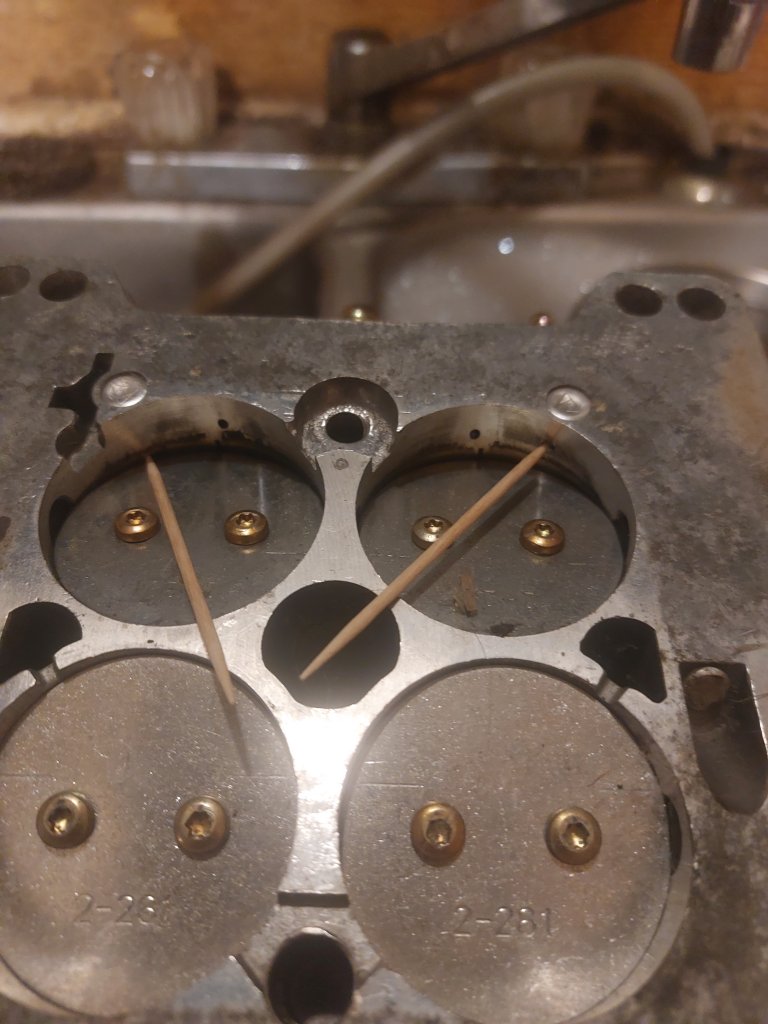

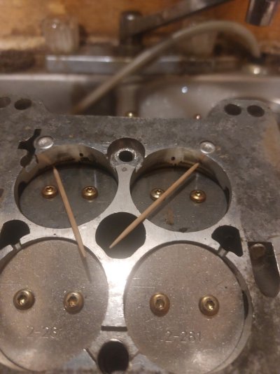

Ported vacuum and manifold vacuum are the same once you open the throttle plates,just a hair. They shut the vacuum advance off at idle to burn late and clean up the tail pipe. I even tell people that can't pass CO emissions,retard the timing a couple of degrees it'll pass because it's still burning the air fuel charge in the manifold. The factory even has a thermo vacuum switch that changes from ported to manifold based off of temperature,it defaults to manifold if the engine gets too hot to help cool it down. I'd run manifold vacuum.. The toothpick on the left is ported the one on right is manifold,as you can see once you crack the throttle they are both open,to manifold vacuum.
