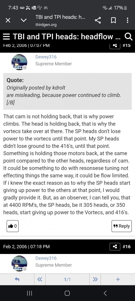

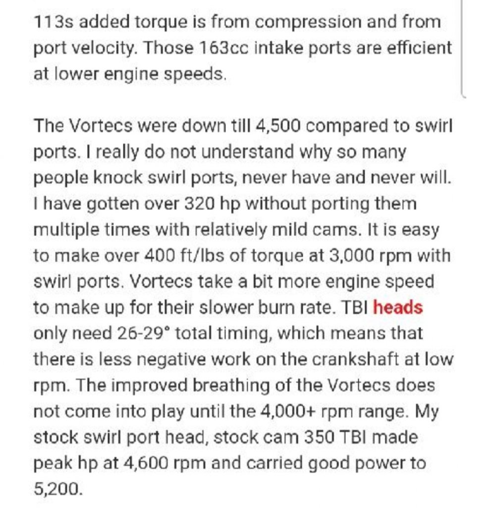

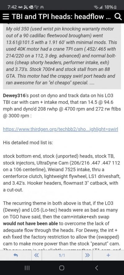

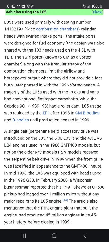

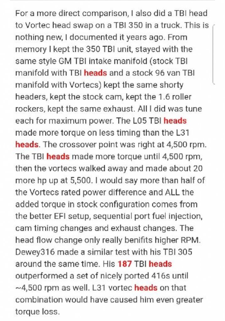

If it were mine it would get different heads,rings,rod bearings,headers,and a cam. You've got 76 cc heads,you don't have enough compression to run much cam. Yep I'm going to get cruzicified here but A pair of TBI heads that nobody wants, would be dirt cheap,bring compression and torque up a bunch,stay with a small cam,929,edelbrock performer,MTC 1,so you got all your power below 5000 rpm. Yes there are lots of better heads than TBI heads but for a dirt cheap low rpm build they'd fill the bill. You can ring and bearing the block in the truck,if you aren't pulling the engine.
OK, so I'm trying to keep up with you on this because a lot of it is Greek to me. Where could I acquire TBI heads? I'm not seeing anything on the used market.
I've found a few articles. My understanding so far is that I could look for something off of a 91~ SBC. I'm reading that they will bolt on the block but the intake won't fit. Is that what you meant by Edelbrock performer? (Edelbrock makes a performer version of all their products it appears).

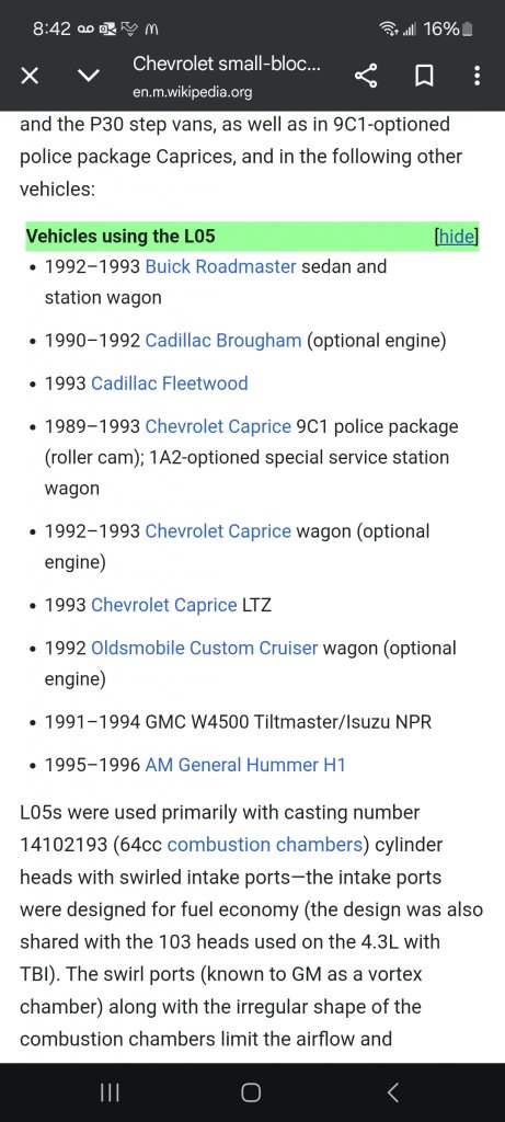

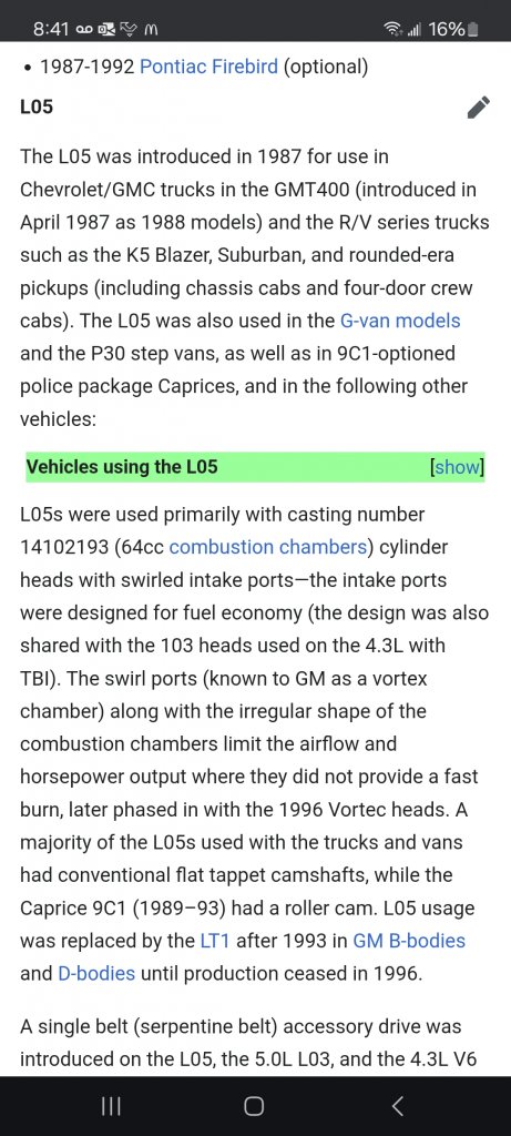

Tbi heads were on all throttle body injected 350s and 305s 1987 - 1998 Cadillacs,Chevrolets,Buicks.( you do not want them off a 305).Your manifold or any CHEAP,think used performer manifold, will not bolt straight on,4 bolt holes are there but at the wrong angle,NBD a grinder,a dremel a drill bit will oblong the holes so they work. Or get a 4bbl manifold off a Truck or caprice with center bolt valve covers. When I mentioned performer before I meant a performer cam,it's a little bigger than a 929 cam or an MTC 1 cam the heads and intake should be dirt cheap used,Junkyard,craigslist,market place etc. The TBI heads make best power at 28-30 degrees total advance,most other SBC heads make best power at 36 degrees. So the TBI heads are not lighting off the mixture as early this means more burn at closer to TDC so less power is wasted fighting the piston coming up on power stroke,so less wasted power more torque,more mpg,less chance of detonation. Do some research on MBT minimum best torque,minimum best timing. Lots of people hate these heads. They are not a true performance head,they are a good low end power head,torque,mpg. I'll post up some results from people that actually used them on quarter mile cars, no they are not as good as some heads,but not as bad as people make them out,and for an under 4500 rpm budget truck motor,I think they are a great choice. P.S. 20 years ago I hated them too! I'll get more screenshot of cars running 13s with TBI heads guys using them on TPI cars for more lowend since the TPI manifold kills the top end on them anyway. ALSO I HAVE NO IDEA WHY THERE IS A THING AT THE BOTTOM SAYING I AM AN AMAZON ASSOVIATE AND MAY GET A COMMISION. WTF WHY IS THIS POPPING UP ON SO MANY THREADS?

Did you read the article/link? I think the heads are the most expensive part.
I actually missed the link. I'll keep an eye out for one of those model cars. That's pretty cool.
