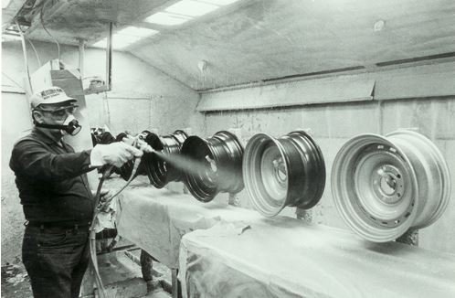

That sounds right to me. I hope the one can of paint will do it for just the one rim but will hopefully be able to find another locally if I need one. And if the surface prep turns out to be just a cleaner, I’ll find a suitable primer.
Just found a photo from the factory and it is clear they painted all surfaces, so you are dead on. Thanks.

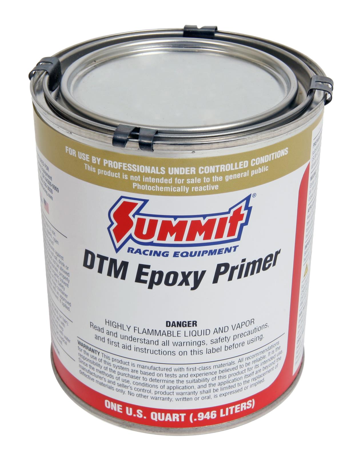

You will need to paint every surface with a "direct to metal" paint since they were sandblasted, then spray just the face of the wheel to get the factory look, "DTM" paint comes in different types, epoxy, enamel, etc but all have the ability to bond with the metal better than a standard primer and promote adhesion which is the goal.

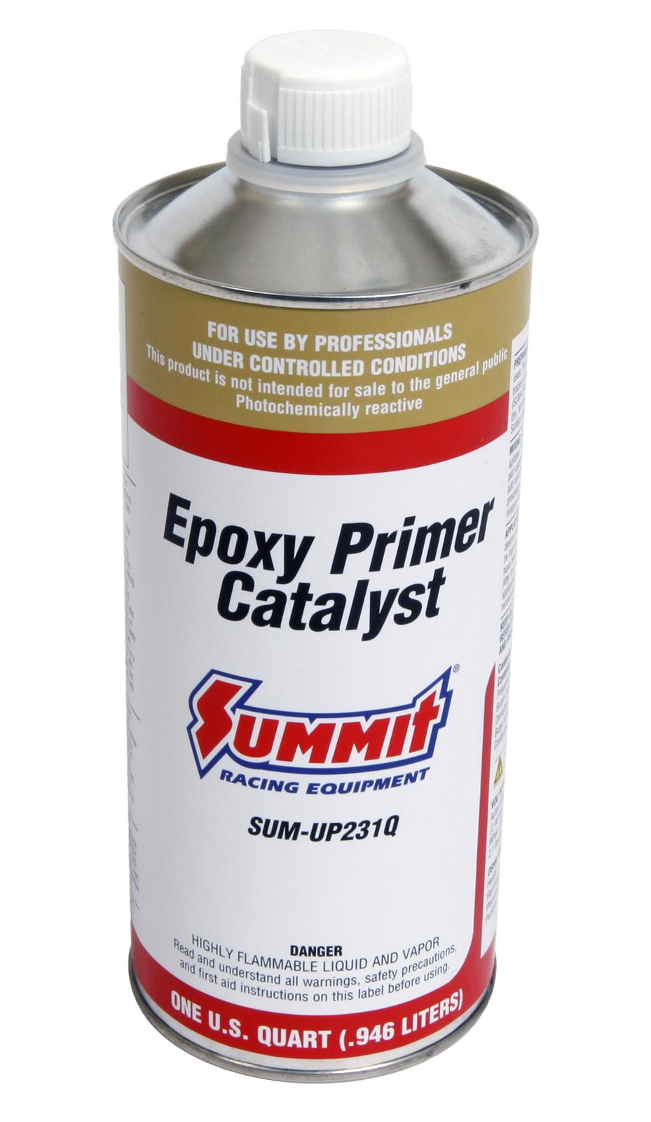

I would make sure it will accept paint on top of it, not all will. POR-15 is a coating to prevent rust, I would read all the directions.
Getting into something as simple as painting wheels, to do it right, can get expensive. I purchased black epoxy paint and used single stage urethane for the silver mixed at the local paint store. To paint 5 complete wheels, you may need more than 2 quart of epoxy/ catalyst mix due to the amount of overspray and such. It wouldn't surprise me if I had $125-$150 in materials just to paint them after having them blasted.

You can use spray bomb etching or dtm primer and paint. It will be fine. Not as good as good paint or powder coat.
Yes of course you want to put “something” on the inside of the rim. Would be silly to just let it rust instantly and perpetually.
I’d just order a can or 2 of what you need off Amazon. Although Vato Zone carries Upol primers which are decent.

Even if he was painting 5 wheels he wouldn’t need more than a pint at most of etching/epoxy/dtm primer. It’s 1 dusting and 1 light to med coat, just enough to cover.
For comparison, I only used slightly more than a gallon (maybe 5-6 qts sprayable) of filler primer also thinned for sealer on an entire truck including the inside of the truck bed. And 3/4 of it ended up as dust on the shop floor.
Although depending on future use it makes sense to buy materials you’ll use “later” as well. Since larger volumes are cheaper. Auto paint has a very long shelf life. Almost indefinite in context. I just painted some parts last year and used 25 year old clear. Regularly I’ve used 10-20 year old paint and primer.
