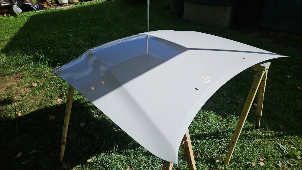

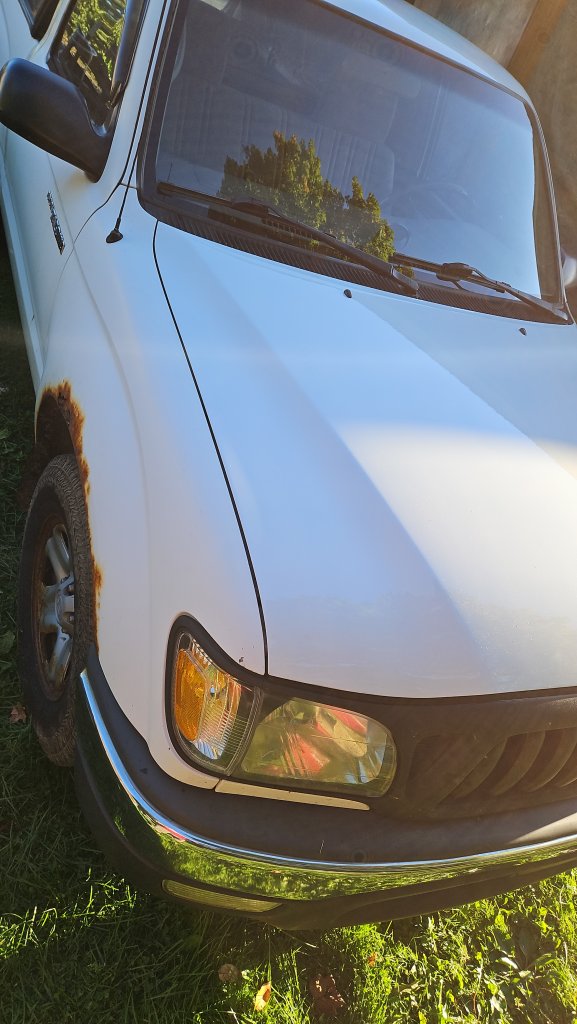

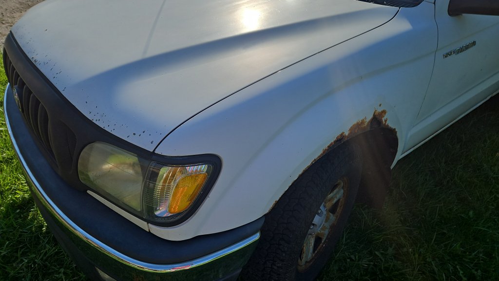

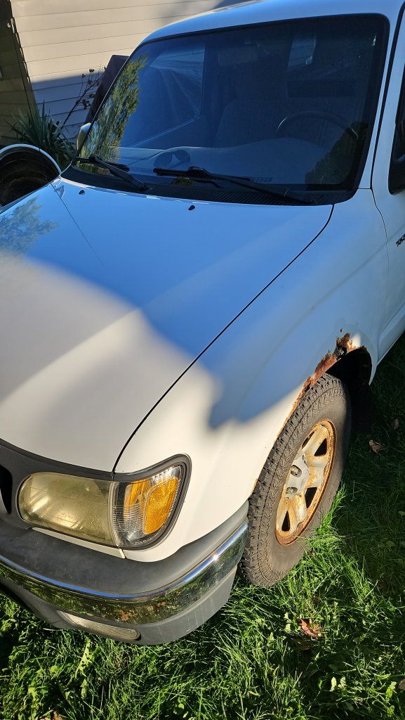

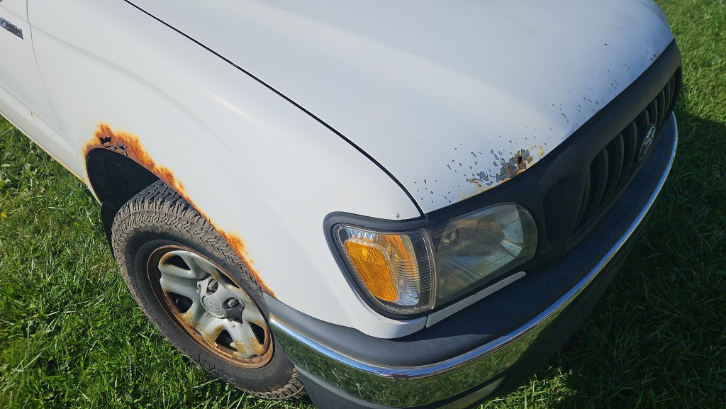

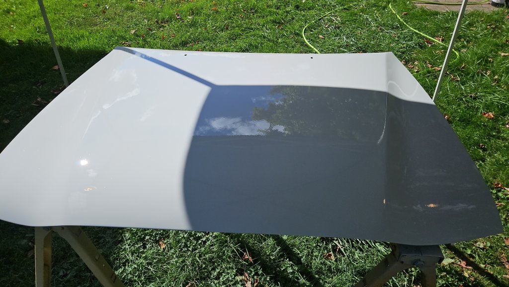

Hood is done and my brain is still doing 100mph.
Shooting the color was completely different than the clear. Clear was like shooting water.

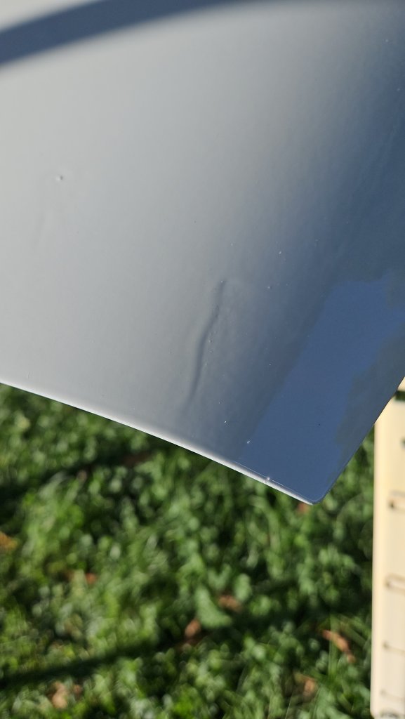

With the color, my passes were spaced too wide and I moved too fast. With the clear, I moved way too slow.
Ended up with a little orange peel here and there and decent sized run of clear.
But it's all good. This was all about gaining experience. (And this is way better than anythin on the taco now) Like a lot of things in life, ya just gotta step out and do it.
I do have alot to learn with getting the gun adjusted right and patients. I always struggle with patients. The biggest thrill was knowing I did it. Not perfect, but certainly not fubar.
I know the next step is cut & buff, but that's expensive too. So, the big 10's roof and cap will probably get that treatment when the time comes. The taco's fenders and the big10's rocker repair will just be as shot.
I bet paint for that big wedge cap is gonna run 5 bills.
I just have to ask...what is with all the freaking little tiny "no-see-ems" being attracted to wet paint? Dag-gummit anyway!! Good argument for a paint booth.
I probably won't do the fenders until spring. I got lots to do before winter.

Ya nice job! If you ain’t gettin the runs here or there you’re not spraying a wet enough coat. That looks great out of the gun in the one pic.

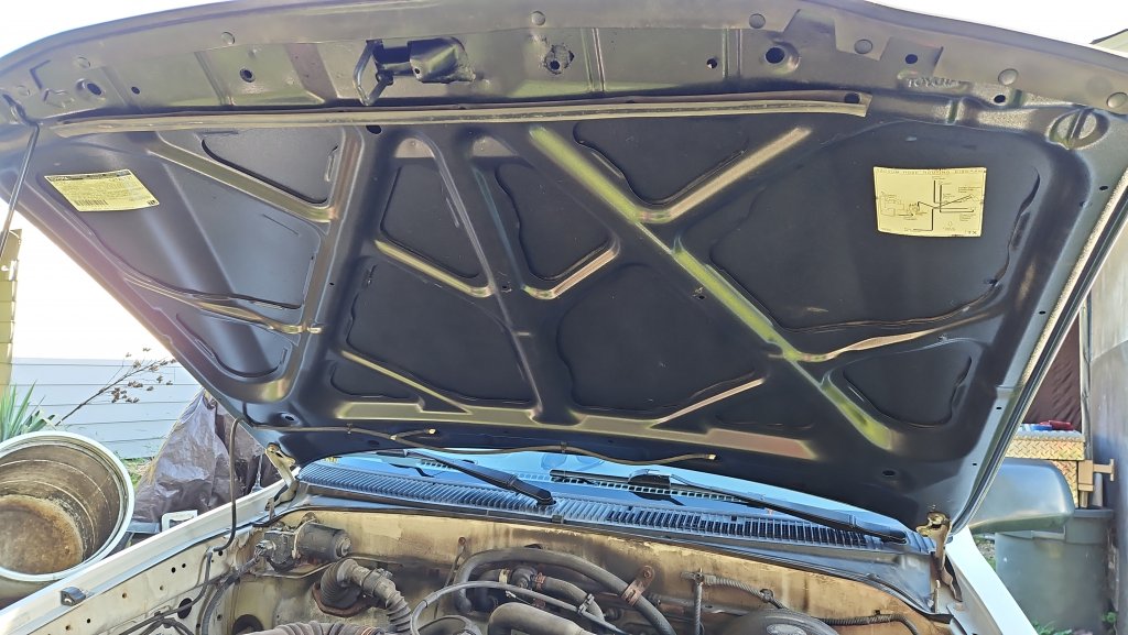

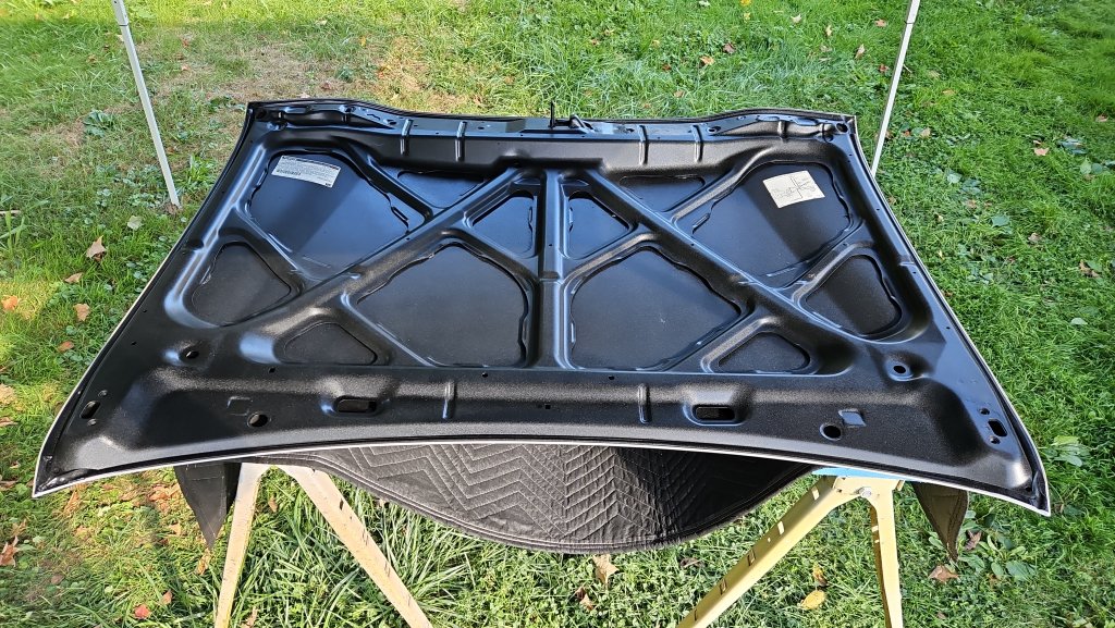

Update:
I used a reducer in the clear after having been instructed not to. (and he wonders why he gets a run) I had not realized I reduced until long after dark. After talking to a couple collision guys, they said they always use reducer in the clear. NBD.
I'm going to change my "spit happens" remark to "runs happen". (dual meaning)
So, after 24 hours, I flipped the hood over and cleaned the under side and then rattle canned a Rustolum truck bed liner on.
Dang! I should of just done that to the top and saved myself a few hundo.
Yea, education ain't cheep.

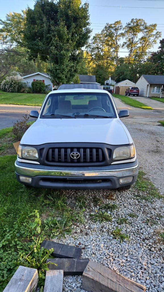

Update:
Original hood was unbolted and tossed aside, yep tossed. (That was fun..lol)
The new-ish hood was bolted in and easily aligned.
In spite of its few tiny flaws, it looks so awesome. Brought back memories of 20+ years ago, when it was 200,k mikes less.

they make what they call nib files that do just that you can file the nibs down and it saves cutting and buffing time they also work on sags or runs but you gotta be careful as a run or sag can take several days to harden, if you mess with it too soon it can cause a mess.
