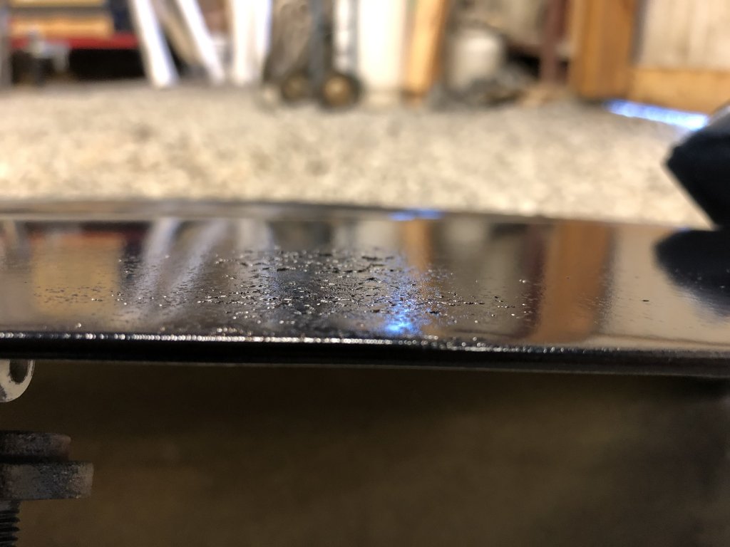

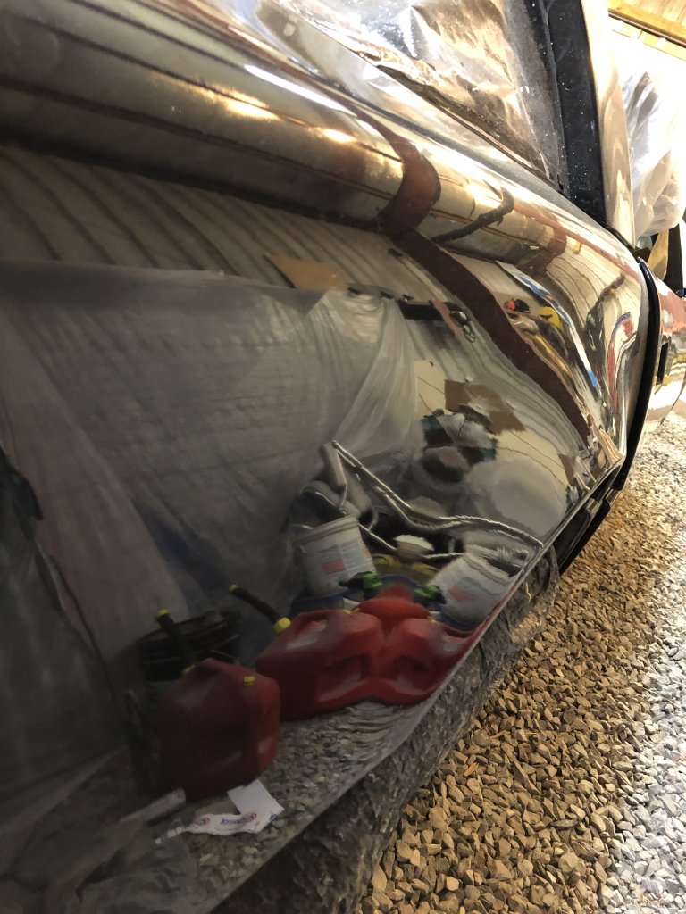

Just my 2 cents, I’ve only ever painted 2 vehicles. The first was an ‘85 Corvette, shot Nason primer, Metallux color, and Nason 2K urethane clear. It was BMW midnight blue, dark color and heavy HEAVY metallic flake. Gorgeous color. The color coat wrinkled up as soon as you laid the first heavy coat. First pic below. I think the paint underneath the primer was garbage (car was resprayed before I owned) and the aggressive reducer in the color coat lifted the garbage paint up off the factory coat. This is partially evidenced by the fact that the wrinkling didn’t happen everywhere. Anywhere the paint did lay well, I buffed out and it looked stellar. Second pic below. It was not cheap all in, but cheaper than PPG. Another thing to note is that I had to go back and touch up some spots later. I could not touch up using an airbrush, I had to repaint the whole panel. Second paint job I did was on my ‘78 Square, it’s the Toyota green they use on their 4Runner (truck in my thumbnail). All I painted was passenger door and the low panel underneath the grill. I’ll likely repaint the hood later. No metallic in it. I used the same Nason primer and this time I used Nason/Axalta single stage. Substrate was much better - either bare metal, factory paint, or dolphin glaze filler. Single stage shot beautifully, turned out great, and I want to say a gallon was about $400 all in, not including primer.

Yeah I experienced the same lifting but it was on fully cured over spray from the secondary color when I was spraying the primary color base coat on the blue truck. Luckily it was only 1 area on the tailgate. I had to do some quick scraping and sanding while base coating the largest portion of the truck and re spray.
The key is IMO to never lay on basecoat thick, especially if over a surface that is more susceptible to damage from reducer.
Never happened to me before in my shadetree experience.
