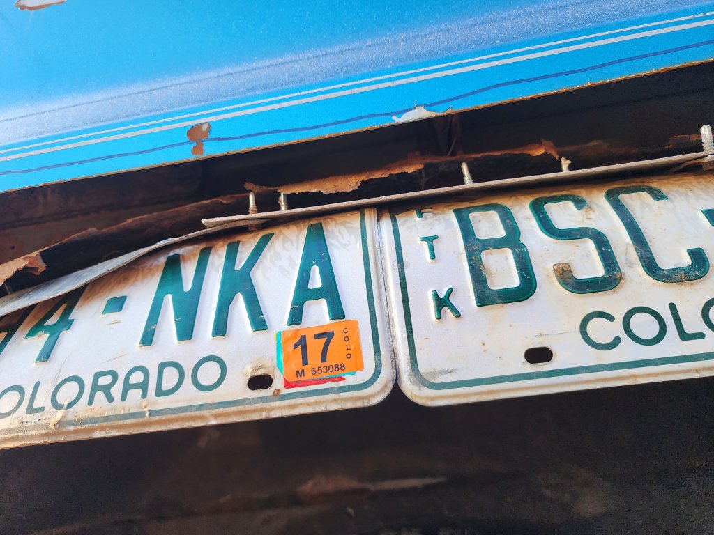

So that all my rot, I have rear arch panels and the bottom panel for the barn doors. Like I said been looking for parts trucks or long beds to see what other options I can come up with.
