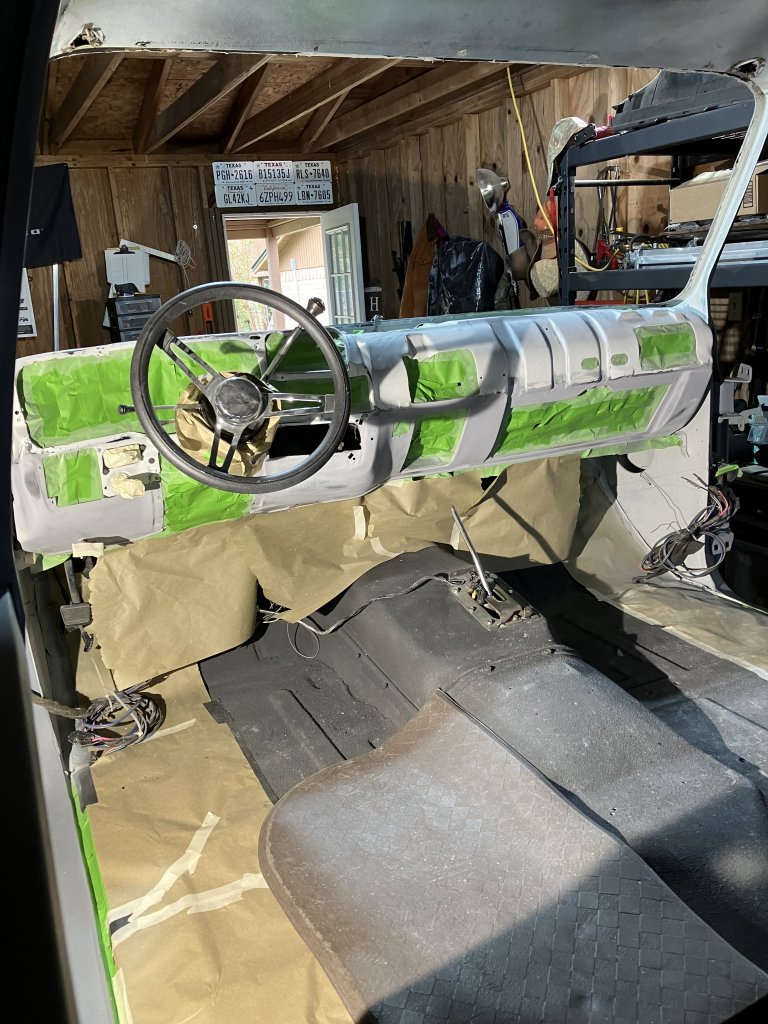

I went ahead and sprayed the dash and cab with the same 2K primer surfacer that I used on the body. It went on pretty flat and will only require buffing with grey or red scotchbrite.
