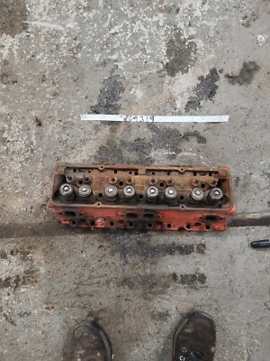

The two castings that are pulling up that seem to be possible are 882 and 624. I don't know if they were getting both for different packages, which I can't see why they would, or if maybe they were getting different castings depending on the plant assembling them.
I do know that according to 77 literature that the trucks under 6000gvwr were getting 1.94 intake valve heads, and the ones over, which would be every K-series truck were getting 1.72" intake valves and no catalytic converters.
Also there is a difference it seems in the original 929 cam in early years in advertised duration and LSA even though the .050" numbers are reported the same and the part number didn't change.

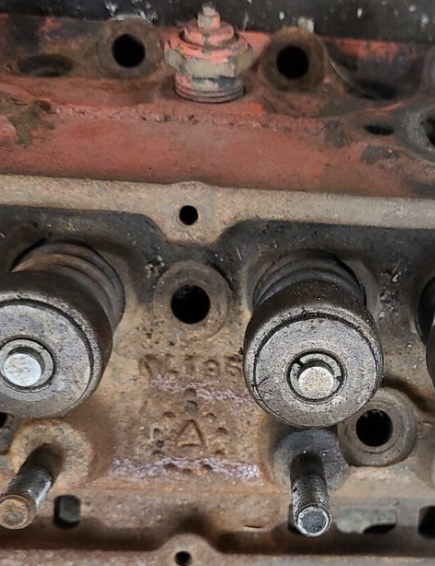

Ive never messed with the smog-era heads, but the castings usually have giveaways on the front face of the heads as to what they are, such as the double/camel humps. They're known as that due to outside casting markers, not the internal ones. The other part of it is OCD (I guess).

Remember that GM went to thinner (lighter) castings in 1977, so if you get 882 castings, there is a difference in early and late heads. The early heads had a straight edge under the spark plugs, where the later heads were “scalloped” around the plugs.
Early heads
Later heads
The 010 blocks also got the change. Easiest way to tell the later (lighter) castings is they had the narrow pad on front, instead of the wide pad.
(Pictures grabbed from the net)
