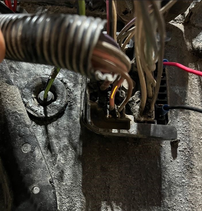

Where does the solid tan wire for the fuel gauge come out of the firewall at?
I just purchased a 1977 C30 Cab and Chassis that I am having small problems trying to fix. The fuel gauge on the truck does not work. It came with dual tanks from the factory but a previous owner changed it to a single tank an unknown period of time ago. The tank is installed on the drivers side, and the primary tank fuel lines were lengthened from the passenger side to the drivers side. The drivers side sender wires are hooked up to the tank but the fuel gauge sits all the way right whether the selector switch is on LH or RH. I got this wiring diagram from this thread https://www.gmsquarebody.com/threads/help-with-fuel-gauge-wiring.9522/
It shows the solid tan fuel gauge wire making a giant loop from out of the dash, down the back of the engine somewhere, down the passenger side frame rail, crosses over way back around the tanks, then back up the drivers side frame rail to this connector
Goes into the selector switch, then back out again as a light blue wire for the drivers side and a tan and white wire for the passenger side. On my truck, the driver side of the circuit is completely intact but the passenger side has been cut. This is the light green wire, the tan and white wire, and the wire coming at the camera is the solid tan wire.
The solid tan wire is long enough to run up the passenger side frame rail to above the starter, the end of the wire has long exposed ends and looks like it was just yanked hard enough and ripped out. I'm fairly certain this is the solid tan wire that (is supposed to) leads up to the fuel gauge and if I'm understanding things correctly the fuel gauge won't work with it ripped out like it is.
I can't find any good info on where this wire is supposed to come out of the firewall from. Does it come out of the bulkhead connector? I looked at some more diagrams but I couldnt find any that helped me. I'm also reading conflicting info on circuit 30 (fuel gauge) on if the wire coming out of the firewall is actually tan, or is pink and spliced behind the engine into the tan.
Can anyone help me out? For clarification, Im trying to find where this solid tan wire is supposed to connect to specifically where it is supposed to go through the firewall at. I looked but cant find any obvious hanging loose wires, and I'd rather not have to unravel the entire harness behind the engine just to find out I'm looking in the wrong place to begin with. Thank you.

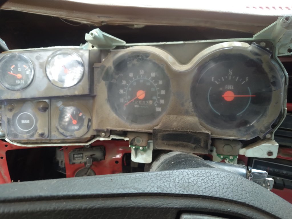

Is there any reason at this point why I couldn't just run a wire from pin 18 on my instrument cluster to the light blue wire coming in to the selector switch? Just completely disconnect the switch and only use the light blue wire going to the drivers side tank.

Ran a wire from pin 18 to the lt blue on the selector switch, no luck. Ran a wire from pin 7 to the lt blue, still no luck. Ran the wire directly to the sender on the tank, tried on both pin 18 and 7, nothing. Maybe my sender is bad, maybe my gauge is bad, maybe my wires are bad. I don't fn know. I'm done with it. I'll just get used to not having a gauge in this truck. Thank you gmsquarebody.com for all the help you guys have given, I really appreciate it. Bye

@Timtom if you're still working on this I might have a bit of insight. You're asking about the solid tan fuel gauge wire. Yes, it is Circuit 30 on your diagram and it originates at the dashboard fuel gauge. It proceeds out of the firewall bulkhead connector (more on that later) and joins the harness that goes to the starter, and then proceeds on its own (near the headers!) down the passenger side frame rail. Circuit 30 terminates near the passenger tank in a small plug, connecting to Circuit 30A (also tan). This is illustrated in your diagram. 30A goes over to the drivers tank (but doesn't connect to anything), and then up the drivers frame rail to the firewall plug in your first picture.
See my thread for a picture of that small plug (near the passenger fuel tank) https://www.gmsquarebody.com/thread...e-to-tank-unit-as-they-did.42060/#post-889897
This whole circuit (30/30A) doesn't connect to anything else, and goes directly from the dashboard fuel gauge to the tank switch.
If I understand you correctly, your Circuit 30 is broken between the firewall bulkhead and the small plug. If that's the case then there is no connection between the fuel switch and the dashboard fuel gauge.

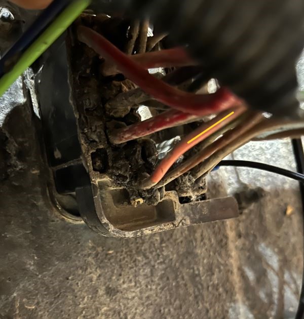

On my 1980 K15 I have a tan wire coming out of the very bottom left of the firewall bulkhead connector. I believe that is Circuit 30 that your original question is asking about. You've identified the right circuit in your August 22 posting of the wiring diagram, but I'm not sure which wire you're illustrating in your picture that same day.

I'm posting pictures of my firewall bulkhead connector to support my post above. It looks like the bulkhead is different on my 80 K15 than the 77 C30 that @Timtom posted, so this won't really do @Timtom any good, sorry. My Circuit 30 is the wire in the bottom left, which looks to me kinda... cantaloupe color. Go with that. I drew a yellow stripe on it to illustrate.
