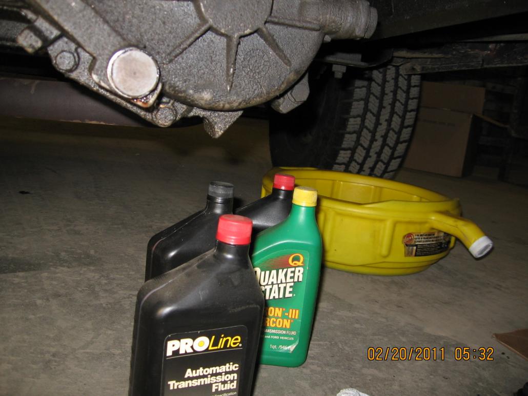

NP241C Transfer Case Fluid Change

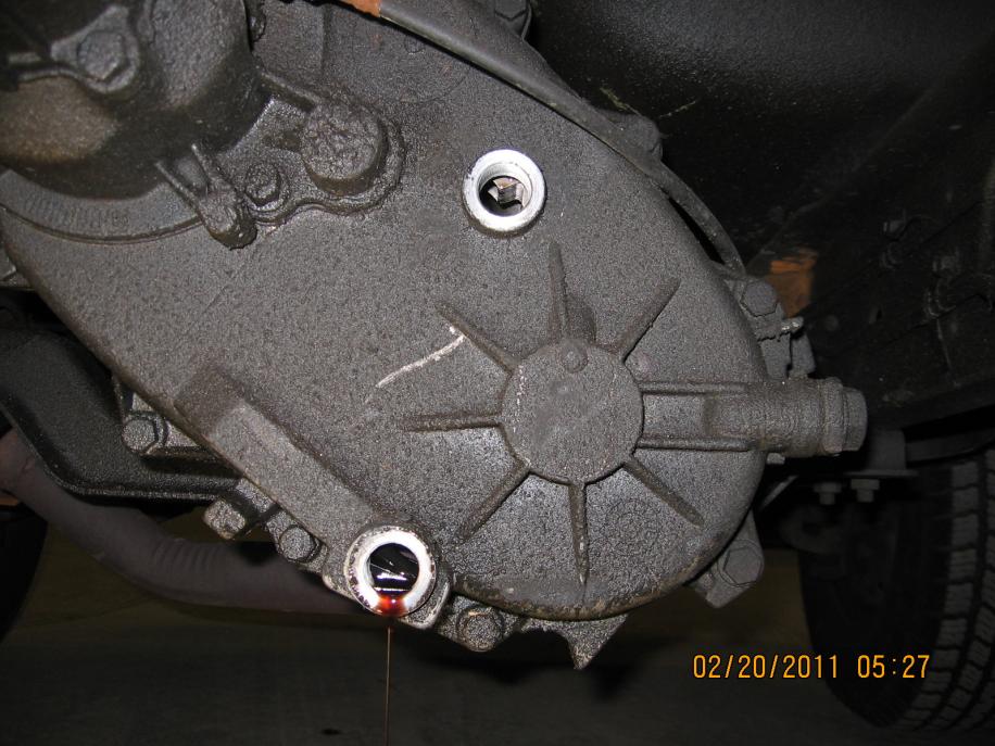

Both drain and fill plugs are located on the rear of the unit. I did not bring my large wrenches and used an adjustable to remove them, but I measured them and they are somewhere around a 1 3/16" to a 1 3/8" Wrench size.

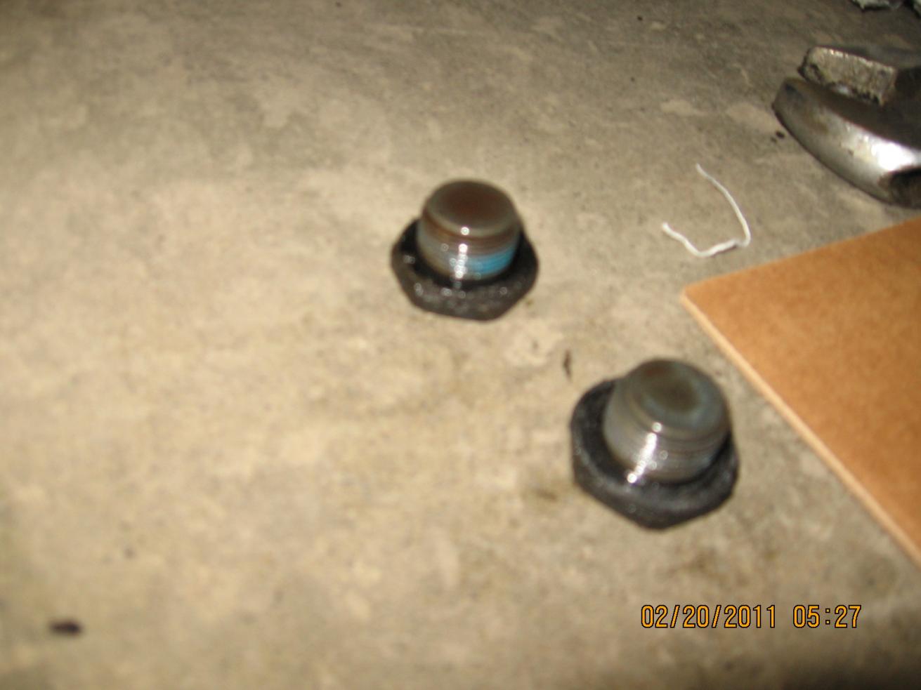

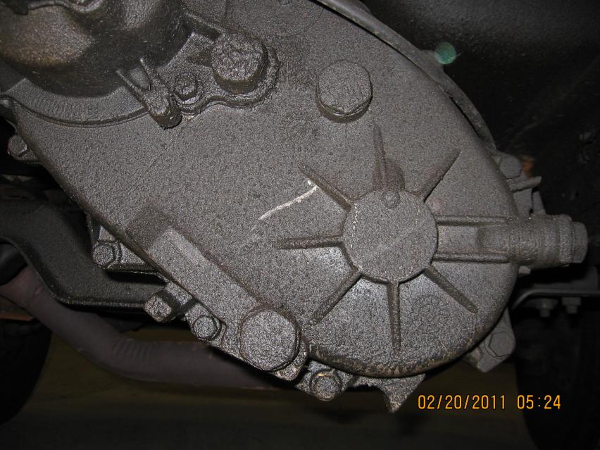

Remove the fill and drain plugs and let drain. Lefty-Loosey. Clean any dirt and grease off fill plugs. Note the plastic sealing washers on the fill plugs, make sure they are clean as well as the surface on the trans case where they need to seal...

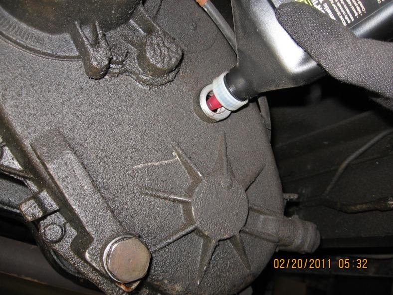

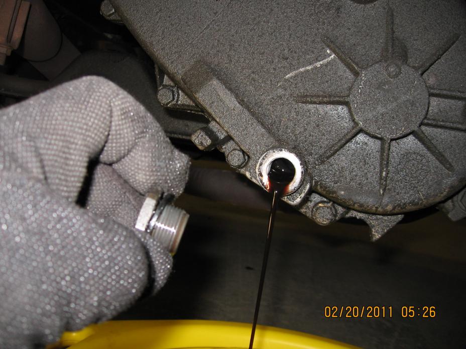

Use Dextron/Mercon II for this unit. Replace drain plug and fill until it runs out of the bottom of the fill hole. This unit took 3 quarts.

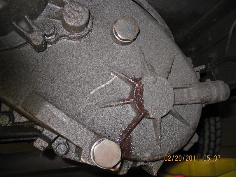

Once fluid runs out of the hole, replace fill plug and your'e all done. :handshake:
