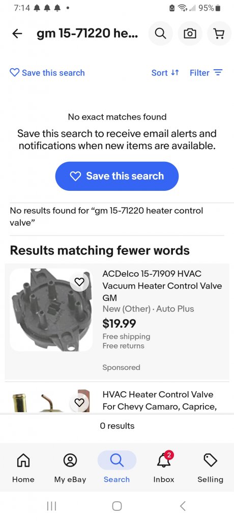

I believe LMC HASC em
Have been unable to locate on LMC. I found the OE part number 15-71220 but no one has it.
Anybody have one in a parts rig they'd part with? I just need the rubber bit really, the assembly seems OK.
squaredeal91
Mar 10, 2023
3,118
5,891
Cave junction Oregon
Greg bush
1991 SB
5.9 Cummins 12 valve
Found this on ebay
Item # 266342113866

@Soundmound no they are not suppose to hiss. I have no idea where you'd get a replacement other than Greg's link.
