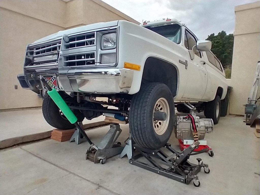

I'm trying to install my np203 transfer case with a floor jack on a truck with 6" lift and 35's
Any suggestions?

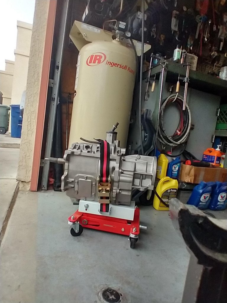

I'm thinking about buying this jack(Dont want to)
But i would still need blocks since its so high.

that strap would hold it down also bigger area for it to lay on flat with out it moving back and forth.
This was my suggestion. I have that jack and it is worth its weight in gold. However, I still had to use pieces of 2x4 blocks to get it high enough and that's on my K20 with 2" lift and 31 inch tires.
Ok you convinced me ill be buying it.
