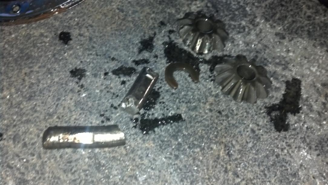

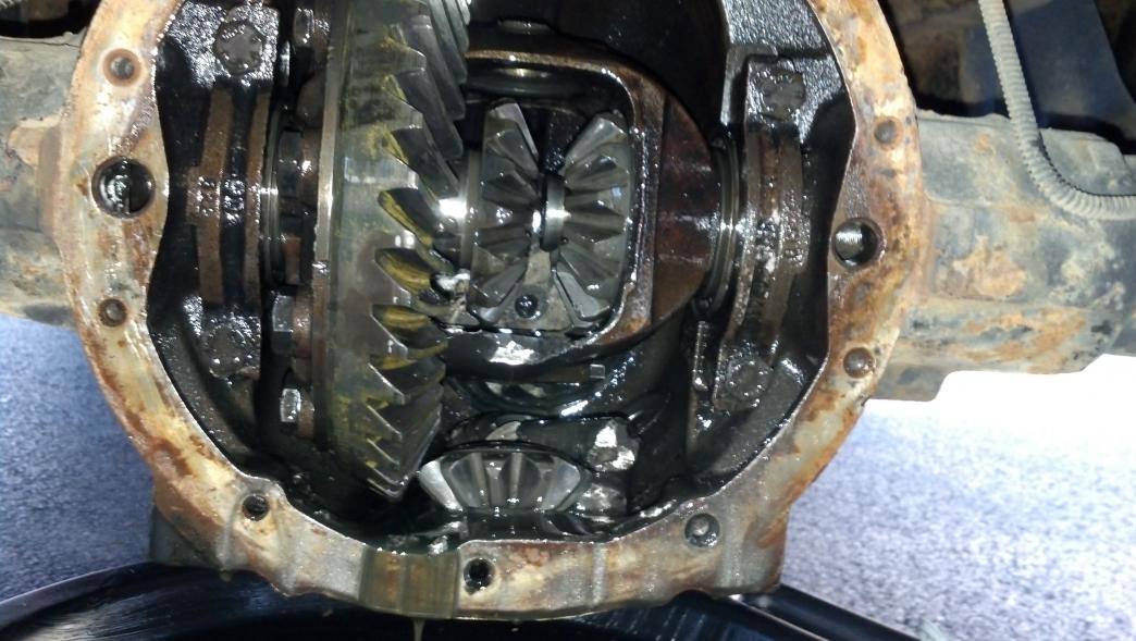

OOOHHH THE HUMANITY!!!!!!! hahaha
Well the spiders grenaded in the differential assembly.
Here is my hyposis:
1. Spider pin was bent causing grinding at high speeds with no power on the system
2. when the spiders gave the Tcase freaked
3. Disessembly was pointless of the Tcase, BUT removal of the shaft allowed me to get the tcase back in sync with the overall system.
Everything seems to work great exept the rear axle is shot. THANK GOD JUST THE SPIDERS haha. Guess I'll still just use this time to swap in a 3/4 ton suspension and 14 bolt ff 4.10 unless any of my friends around here have a spare diff and spiders.

Wow you're lucky you didn't lose an axleshaft, with the wheel still attached!! Is that yellow marking paint I see on the ring gear teeth? Is it possible someone set up the gears wrong? Also I don't see a crosspin bolt, common mistake, not putting locktite on it!!!

What u see is everything. I guess someone did a horrible rebuild on this. Bastards.

Real lucky. I am suprised when that crossshaft came out, and as the carrier was spinning at highway speed, it didn't break the carrier. Thankfully the shaft sheared instead, but yep, does look like someone didn't locktite the retaining bolt, and that allowed the crossshaft to fall out. A trip to a pull it yard, a few pocket parts and you're up and running again. If you do this, be sure to get all 4 spiders from the same axle. Don't mix and match them if used.
Also, make sure you're getting 28 splines outter spiders and not 30 or your axles won't go back in. I think its 87 and down are 28, 88 and up are 30 spline.

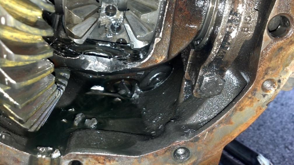

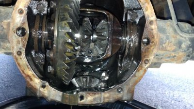

Sorry third pic didn't post....the carrier is cracked and missing a chunk too

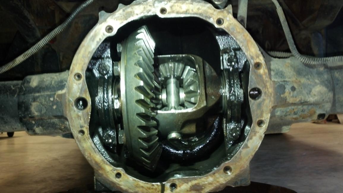

ok the first photo is the carrier now. The second is a photo i took last month when i change the fluid. (Sound was there before i did that, so i know i didn't cause this lol)

yeah, I figured it would be hard to shear that crossshaft by hitting the case and not damage the carrier too. Now you get to proceed with the 3/4 ton axle huh? :grd:
