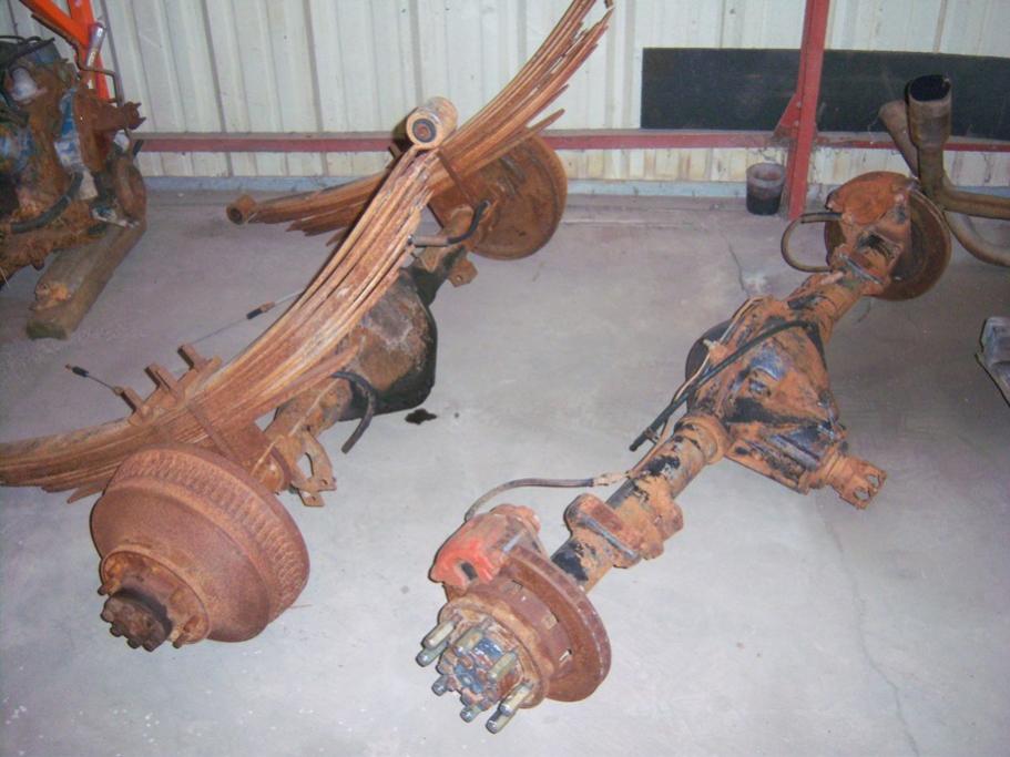

Seems all 14 bolts have dried up around here. About a year ago, you could get a 14b FF with 4.10 or 3.73 for $150 and choose the one closest to your house. And that's how it works too. When you find 1, you'll find 2 or 3, but that's a good thing because it gives you bargaining power. I was thinking I paid $150 for my CUCV 14b FF with Detroit Locker, then I found my thread from the day I brought it home. I only paid $125 for it. I remember now too, he wanted $150, but I helped him pull it out of the truck and got it for $125. You can get Disk brake conversions for anything now days.
