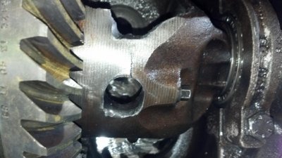

Here is the damage to the carrier

Sorry I got pulled away for a while, I would definitely NOT be driving on that carrier. Not worth the risk.
47,211
9,489
You found out the front is OK right? I'd just take the spiders out of the rear end, put it in 4 hi and drive it for 15 miles. I wouldn't even put the cover back on and oil in for 15 miles. The damage is done. If the R&P aren't trashed yet, they'll survive 15 miles with no oil just fine. Now you will have to keep your side gears in since the C clips hold the axles, but just take the broken bar and the 2 small broken spiders out of it and rock with it. I'd try to keep it under 40mph.
