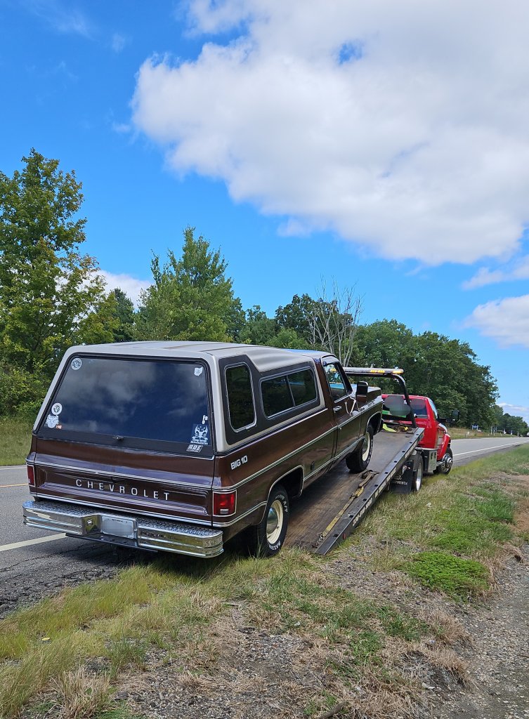

Well...
Let me start by saying this snafu was completely my fault.
After the refresh I had run the truck for almost 2 weeks and no problems.
I decided to use it for the camping trip.
Within a half mile of the park...BANG!!!
Everything went dead. 5 seconds later...BANG!!!...again (of similiar 9mm caliber)
I had no power, engine dead, shifted into neutral, no starter, no flashers, no horn...dead.
I coasted to the side of the road shoulder.
Wife said she smelled something like hot wires/electrical. I didn't smell anything, but since the woohooflu, my smeller is broke.
So, finally got a flatbed out to get back home. Family member took camper to campsite.

Rut-roh! Battery? Loose unsecured cable made contact with exhaust manifold?
Had that happen once, no booms, but pure dead truck and the purchase of new battery. Luckily a friend that lived in the town we just left, was going back home and saw us, and was kind enough to give us a ride to get a new battery and back to the truck to install it.

Sorry, I had to grab dinner and couldn't complete the post...lol
So, none of the mechanical systems appeared to be the problem.
Once we got home from camping, I started to pull the wiring harness out from behind the block.
That would be the fuel gauge wire, starter wires, alt wire, oil pressure, temp sensor, dizzy wire.. Also the house batt wire.
It became obvious, when I pulled the house batt wire, that I had found the culprit.
The house batt charging wire had not been attached back to the top of the valve cover, like it should of been.
I had layed it down next to the intake manifold.
There is an exhaust channel in the intake manifold that heats the manifold and goes right under the divorce choke pull-off mech.
That got hot enf to melt the insulation off the house batt charging wire.
When it did, it blew one of the fusible links on the firewall. And since the starter solenoid is also in that immediate circuit, it also blew that fusible link as well. Hence the 2 big BANG's.
The fix?...a quick trip to parts house and get 2 wire gauge specific fusible links and solder them in.
Took it apart yesterday and fixed it. Put it back together today and put all the wires where they're supposed to be.
It started right up and no damage to the alt or anything else.
Frustrating for sure, but learned a valuable lesson.
