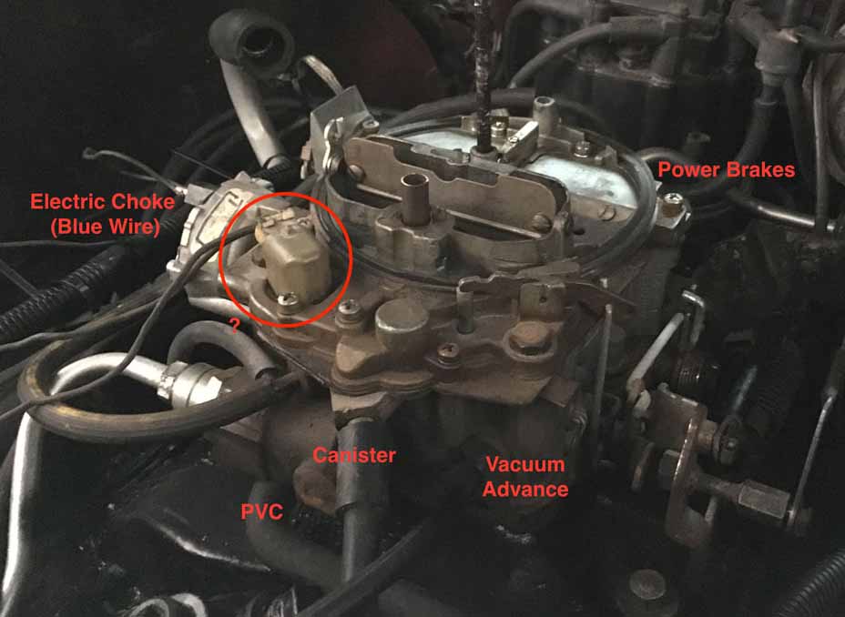

Ok so I found 2 vacuum switch on firewall. Nothing hooked up to them. Are they important? I found the wires just hanging, no vacuum lines.
Also, where does the choke pull off get its vacuum? Lower ports or a special port.

Tip In switch for the mixture control valve in the Quadrajet. I was thinking TCC switch for the other, but that can't be with a Turbo 400, so it must be a 700R4.
They would both had vacuum lines originally.
Choke pull off gets full vacuum less than an inch from it. Front of the carb towards base, if it looks like these, mounted on passenger's side.

Ok Thanks. I guess I need to ask, do I need these? When they swapped the engine to a 350 crate long block I have no EGR valve, smog pump or such. More wire are disconnected on the engine than are connected.

I was thinking one was for the ESC, and one was for the converter lockup... That carb to me looked like an M4ME with a dual stage accelerator pump. I didn't see a TPS sensor on it in the picture.

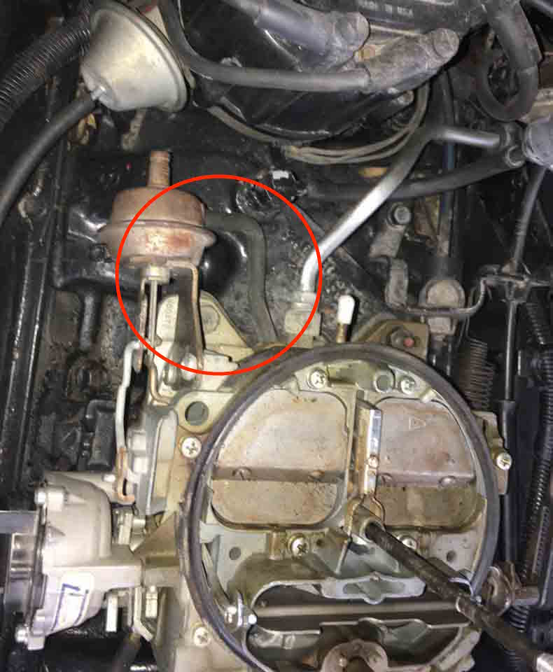

some photos...

You have the two position, mixture control valve (different than the solenoid with full computer control - they are blue) circled. It defaults rich when inop, IIRC. I would probably hook it up if it was mine, but you probably won't be able to tell a difference.

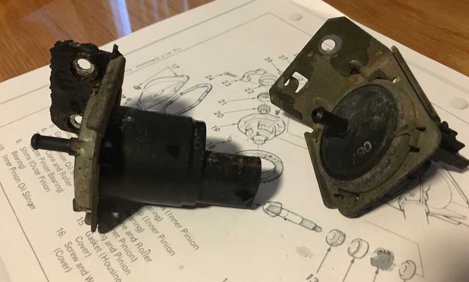

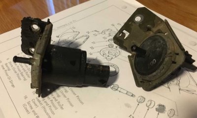

It appears you have a different style choke pull off from what I referenced (mine is from '84 car). It looks like you have a full vacuum connection to yours, which would be correct. The diaphragm in them is typically shot by now, which is why i had the old one and new one pictured. Mine died very slowly and appeared to work when I was watching and checking it, until it finally got bad enough.
IF I am correct that your other switch was for the locking torque converter on a 700R4 / 4L60 transmission, and you have an unmodified transmission, it really needs to be operative. Besides the fuel mileage loss, running the transmission with the torque converter unlocked in overdrive causes them to overheat. The torque converter can even turn blue from getting so hot.

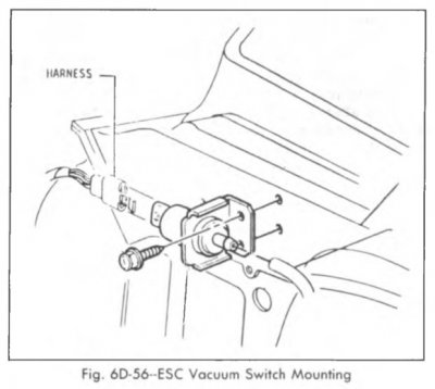

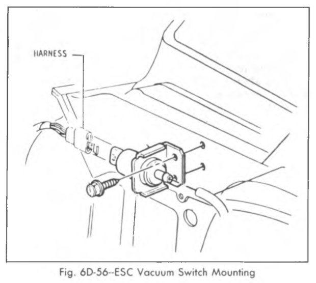

Ok never mind. Starting to get the hang of this.
Switch is a ESC vacuum. Since the modified 1985 K10 I have has no ESC distributor on its motor, it is not need.
