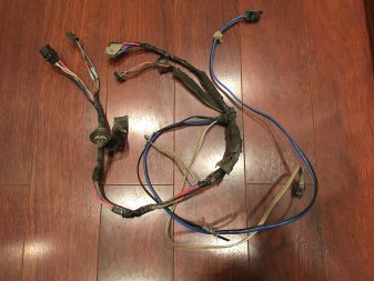

I've got a pics of the difference between a typical OEM harness you're likely to find vs my NEW upgraded replacement harness. This is for the LH side-
OEM:
This harness is as it was pulled from an 86 K5 and shows broken door lock actuator wiring, 3 splices, broken down foam covering and harness tape unraveling.

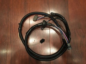

New:
What is different on my NEW harnesses are j1128 spec wiring (rated to 275F), full harness wrap enclosed in flame resistant looming AND features a section of abrasion resistant sleeving after the cab grommet where the OEM wires typically crack/break inside the boot.
Also, the window switch connector as well as the lock switch connector feature dip soldered terminals and heatshrinked to prevent breaking of wire strands @ the connector which is a common issue on factory harnesses.
I've had a few PM's about my window/lock harnesses so I thought I'd share some differences between the two. Nobody else offers repro door harnesses and even if someone did, why opt for factory style when there are better materials to use?

That's nice!! :waytogo:
