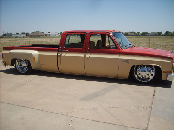

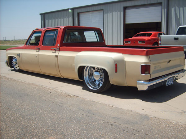

That'd look rly good on your truck hotrod, I don't know the truck personally but here's the link to the build on the truck ill try emailing him aswell edit: you have to click on current projects you'll see pics of it its the first one I sent an email off for yea buddy as soon as I hear back ill let let yea know
http://www.hills-hotrods.com/Index1.cfm
47,306
9,672
Awesome. I seen some better pics of truck too.
