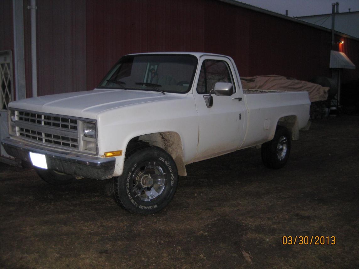

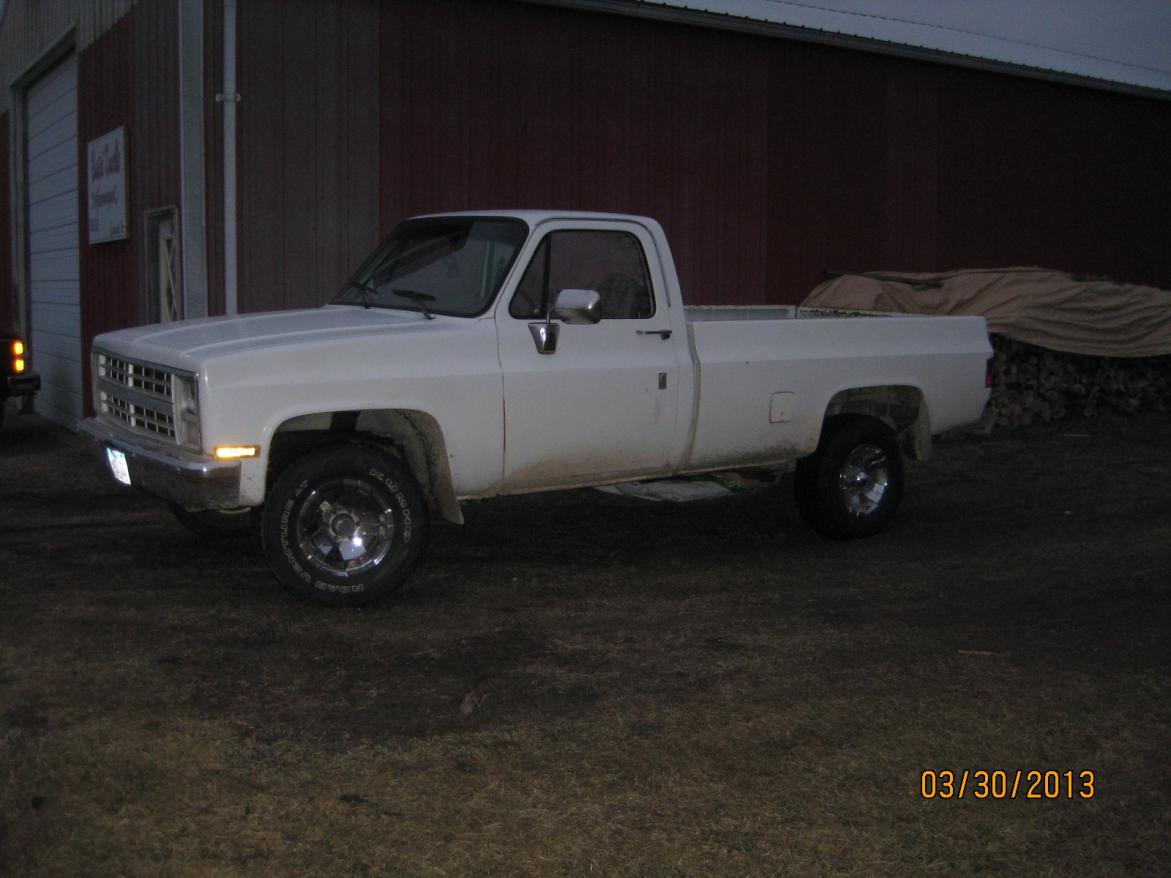

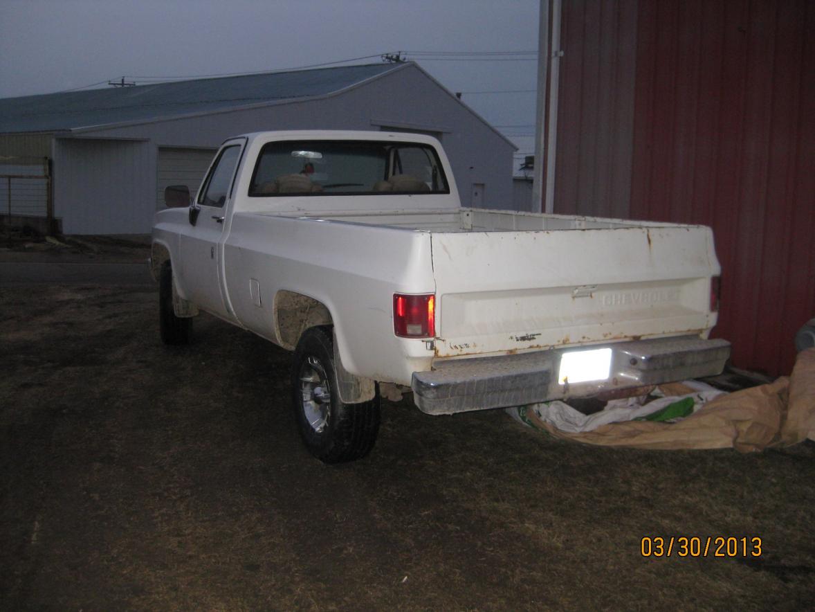

Here's the pictures as promised. Had a buddy show up at the shop this afternoon, He just scored different rims for his truck so the ones you see on the truck are his old ones (16's) originally it had 15" rallies with 235/75R15 on them. We got it up on the hoist and I ended up draining and refilling both axles. I think the original grease was still in them. The 208 case was leaking but I think I got that fixed. Dropped the engine oil and filter and put fresh in. I'm thinking the 700R4 has some grief, at different times today it shifted funny. I'm going to get rid of the flexsteel seat and put a stock one in, just don't like it. I'm thinking a tilt wheel would be good to. Axles are geared at 3:73. Going to need exhaust soon, cobble job on it now. Looks like the gas tank is new. I'm still pinching myself over this one. Funny thing is, now I have a fleet of square bodies.:happy160:
